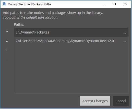

Please note that this path is the default path where my third-party packages are saved and where Dynamo looks to load nodes. This is set using the Manage Node and Package Paths dialogue box (Settings–>Manage Node and Package Paths) as shown below:

Try saving to the C drive instead. Would narrow down if it’s a network blocking issue.
Thanks. I’ll try that first thing in the morning. Is there a specific folder this should be saved to?
Once I save the .dyf to the location on the C drive do I add that path to the ’Manage Node and Package Paths’ list, so that Dynamo knows where to look?
I’d go with the default location, and remove the L drive from the paths for now.
I don’t think nodes will load from nested folders - try adding the deniNodes folder to set of paths directly.

Hi @jacob.small
I tried copying the .dyf file to C:\Users<User>\AppData\Roaming\Dynamo\Dynamo Revit\2.0 with no luck.
I then tried copying the Deninodes folder containing the custom node to C:\Users\\AppData\Roaming\Dynamo\Dynamo Revit\2.0\packages
When I did this Deninodes showed up in the third-party packages list again, but alas, when I restart Dynamo it disappears again.
Both paths were added to the Manage Node and Package Paths directory.
Hi @Michael_Kirschner2
It worked! Thank you for your solution. I thought I was missing something simple…just didn’t know what. I’ll keep this in mind for the future.
