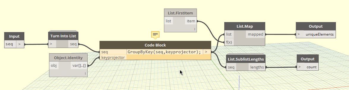

You need to use clockwork 0.9 package for Dynamo version 0.9. See Image below.
Sorry, I thought it would be clear from the title. It is the 0.9 package that’s giving me the problem.
Sorry, i didn’t look at your title. Can you just explain what are you trying to achieve with this node or may be drop a screenshot of your graph here.
Make the insides of the node look like the second image below.
another way
Thanks to all …
John, solution #1 did the trick.

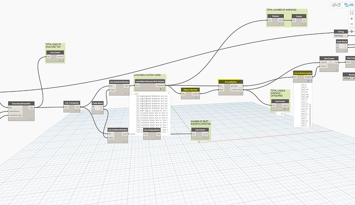

Super useful tip! Helped me to create this definition to Parse Revit Warnings (Excel File)[/caption]
