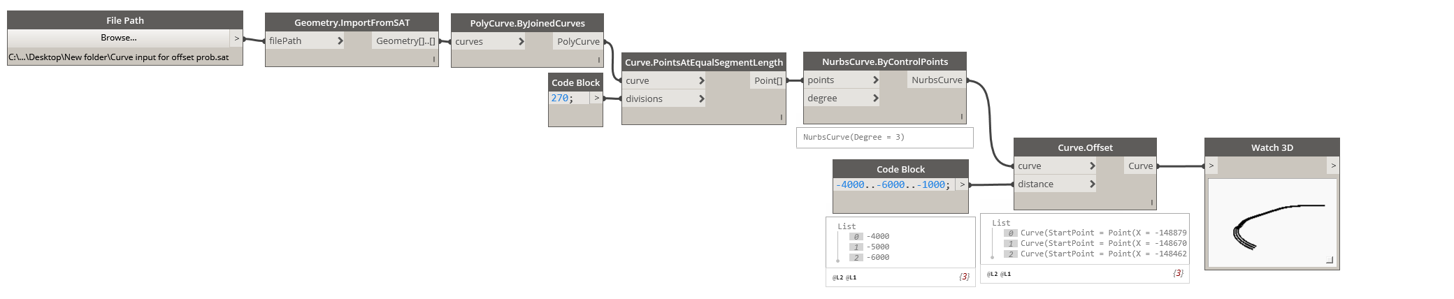

I want to offset a curve which is a polycurve in nature. However, the curve only work at certain distance. Some distance does not work. It says “Curve joined produce one wire in polycurve” I want to use curve.offset instead of polycurve.offset because I want the function to be as flexible as possible as in it can take in any curve.

You’re offsettting the curve to a point where it no longer exists - that is a radius in the curve is less than 5000 units. That will throw an error every time.
@minhchau.nguyen You could try replacing the curve with an approximation that works

Hi thanks, the problems seem to be solved
