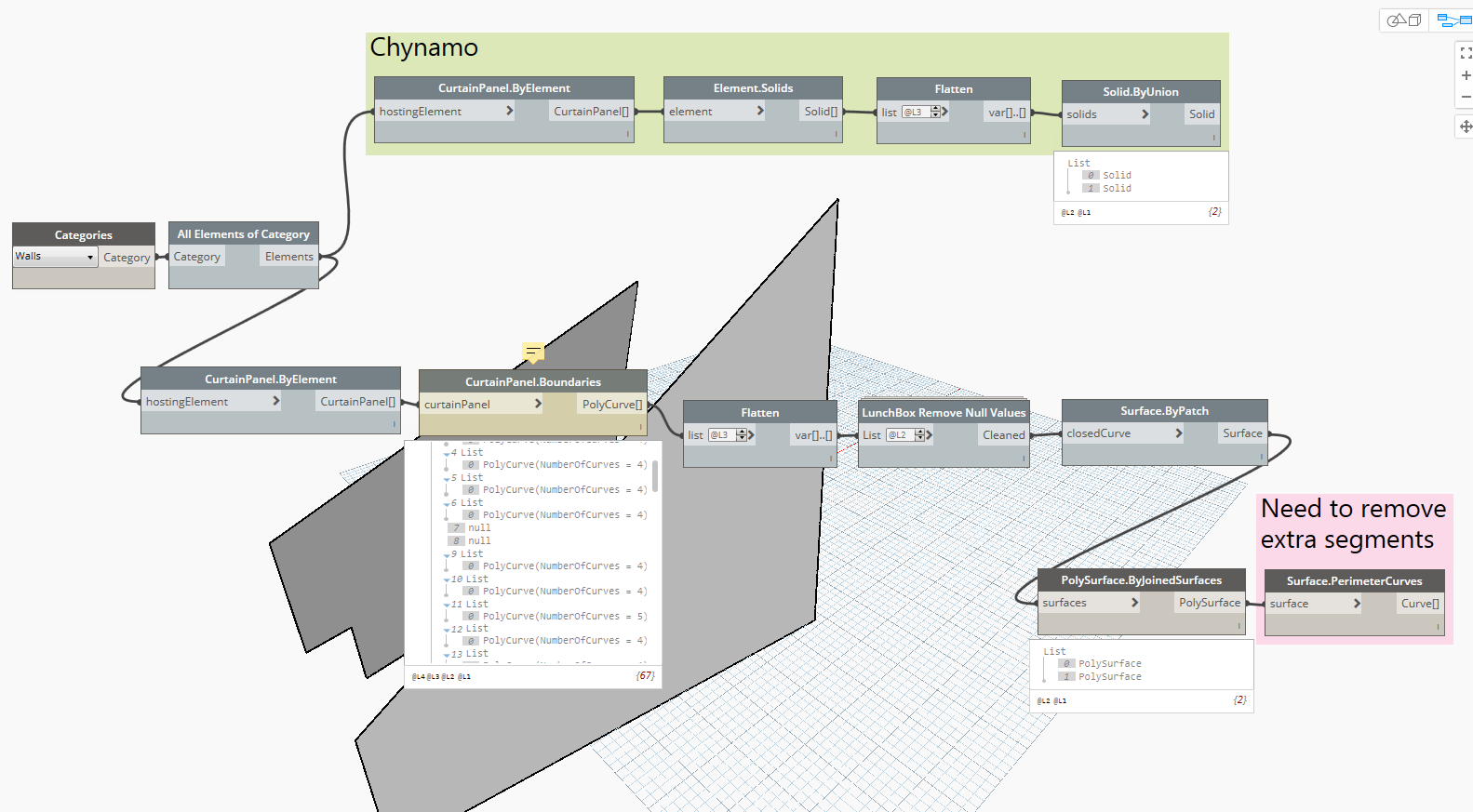

Perfect thank you Yna_Db. That should do the trick. It works with every type of curtain wall. Unchanged, Profile Edited and when attached to a roof / floor.

So I pulled that node apart and it is clever but falls a little short. CurtainWall.ToSolid,took each curtain panel and ran Element.Solid on it. This worked at first but then to make sure I added mulions to my test wall (seperating panel edges). This left holes in the final solid surface.
I found This post by KulKul for getting the curves of all the panels. Applying the base method from Chynamo I was able to get one solid surface.
