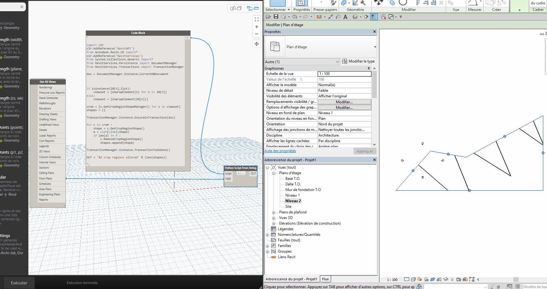

Crop region toggle
hello, I would like to toggle the visibility of my crop regions in all my views to be on, but I cannot find any nodes for that. Also, I would like to reset the ones that are not rectangular if possible. But I cant find anything on the topic to do it in mass. Can anyone help? Thanks!

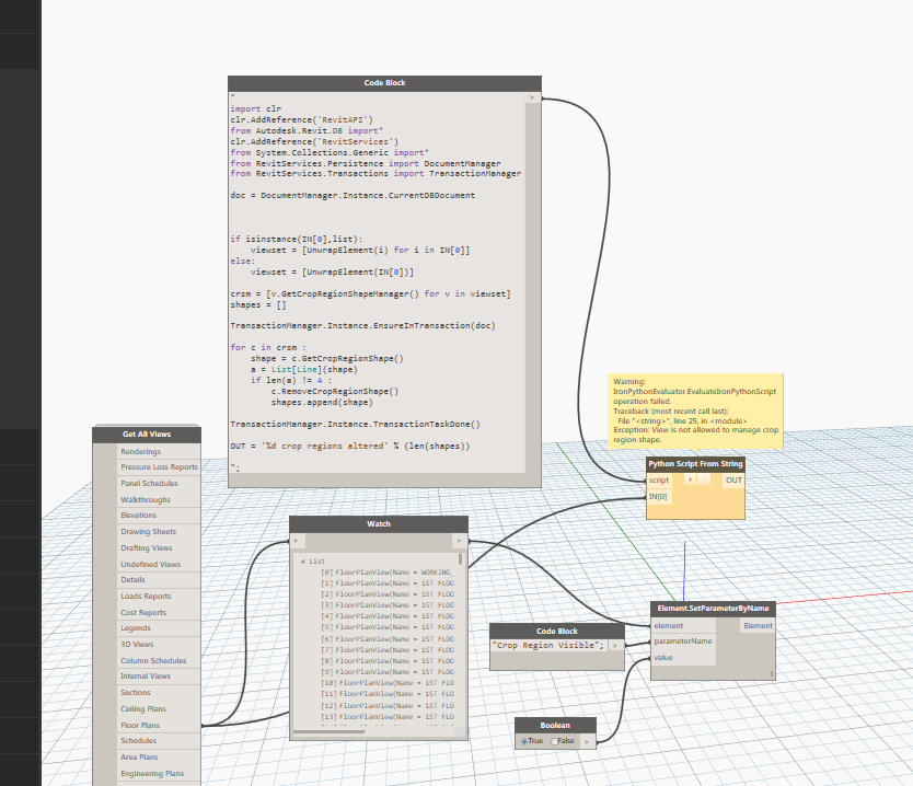

Hi @mix ,
it’s easily accessible as a parameter of the views. It can bet set with the setparameterbyname node :
you just need to translate the name of the parameter in your language.
There are also ways to get and set the shape of tha crop region through the visibilitycropregionshapemanager … but do you just want to reset it to a rectangle that includes all the project ?
Here’s an example of how to access the shape of the crop region and “reset” it :
This code get the number of perimeter curves of the crop region and resets it if it has more than 4 curves… It can be pushed farther but you get the general idea :

Thats great! Is there anyway to reset the crop region if it still has four sides, just that they are modified or not rectangular? I got this error message:
Hello?
