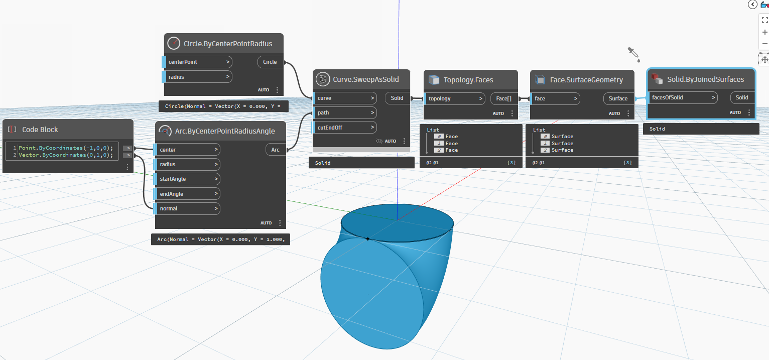

If ever it could help you (a recreation with another node) while waiting for a geometry specialist.
Try attaching screenshots of your script, with the nodes open

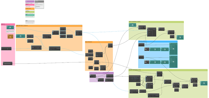

I created a little different script for my needs - I pick polylines (one by one), I select a surface to place barrier posts (a post is a pre-created 3D block), and location (also define the interval between posts). Then I have to choose if the barrier is on the left or right side to create the right barrier cross-section.
Hope this helps, it’s a totally different approach, but maybe you can use some of this

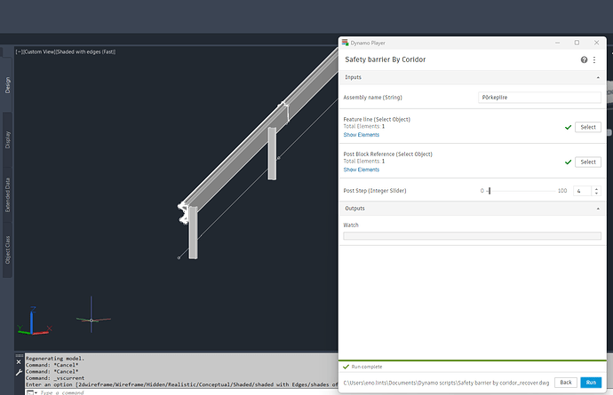

Thank you for the reply. Your workflow seems nice and definitely useful. I’ve made changes to mine. I use assembly and featureline and also block reference for the posts.
That gives me a way of modeling all the same type barriers at once + adjust the step of posts.
