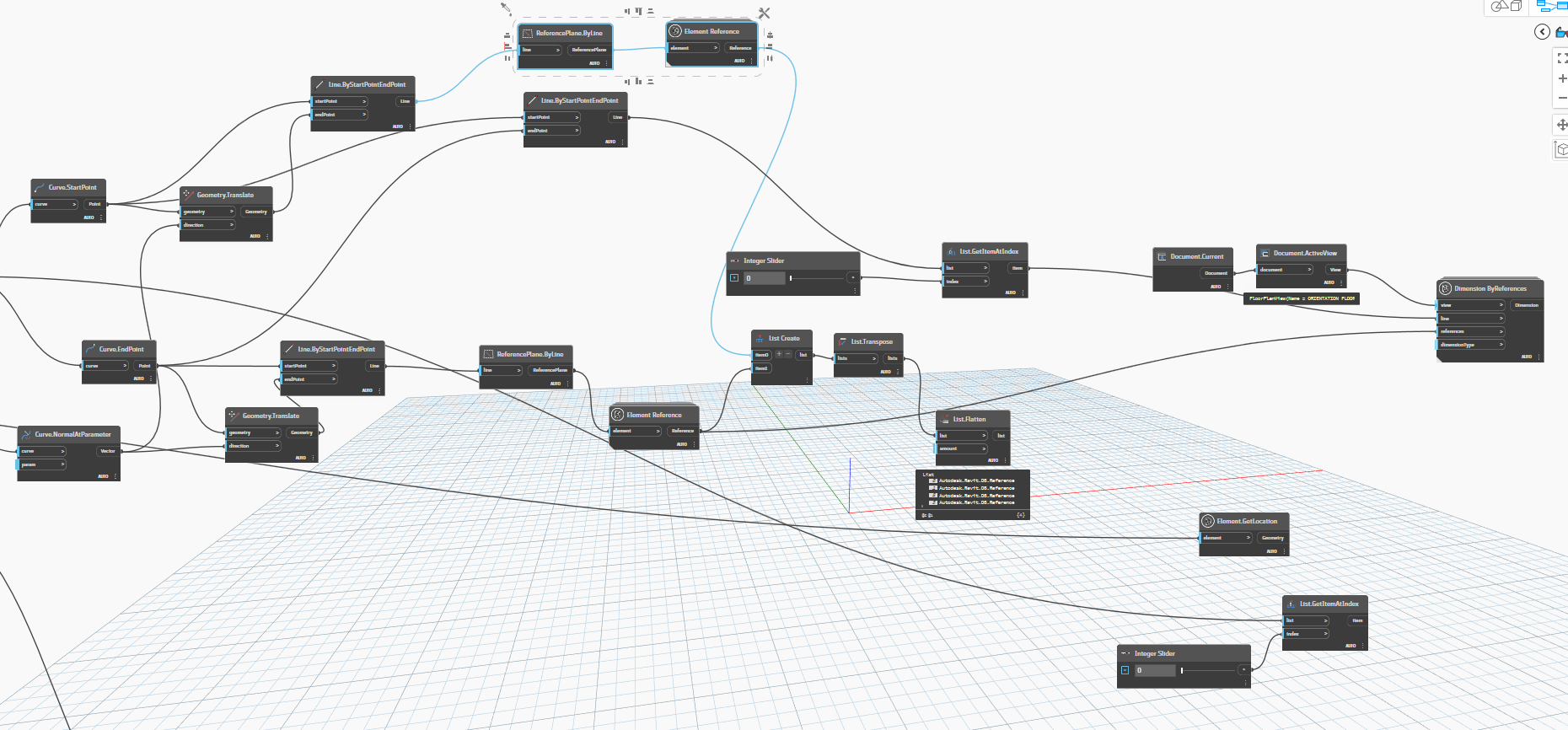

Hello I’m trying to create references from hosted elements be selecting the wall host as a start.
DimensionWallOpenings4.dyn (77.7 KB)
I’m able to get the references from the storefront edges but it’s not creating the dimension from the line. Any help would be appreciated. Using Revit 2024 and Genius Loci 2024 and Iron Python 2.7

Thanks. I’m looking at other ways that I’ve seen it done with converting to solids but not sure what the best process is.
I was able to find an approach that works here.
Dimension openings in walls - Revit - Dynamo (dynamobim.com)
