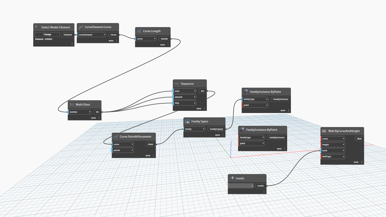

Kindly check above nodes, Here is Revit Plan
I wanted created above plan’s boundary.

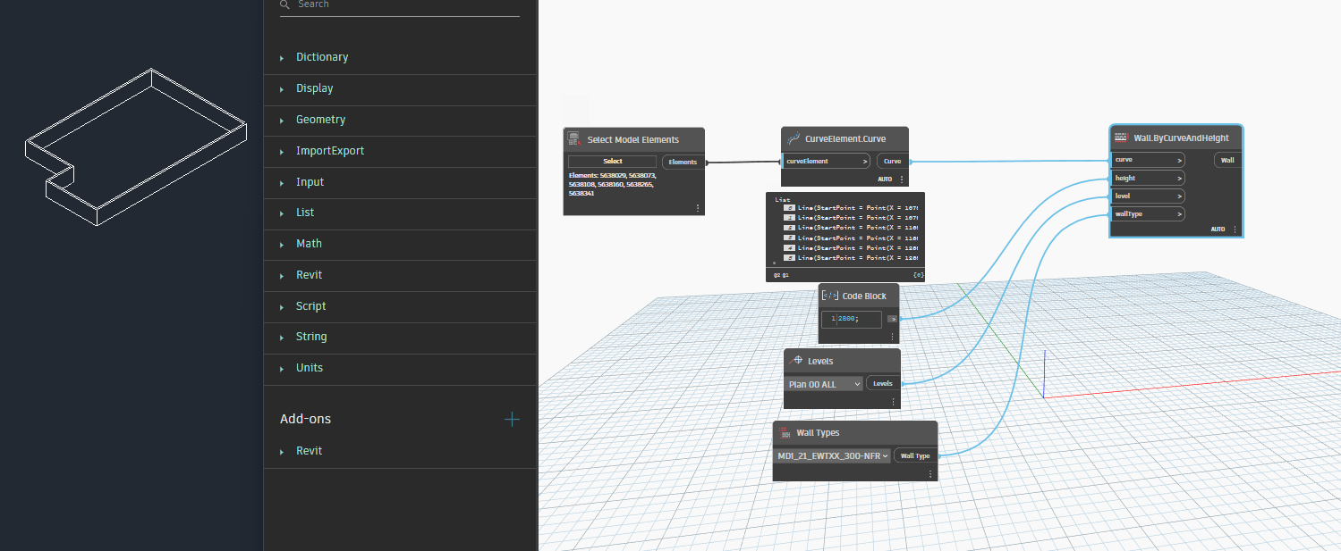

Hey,
See if this works for you?
Hope that helps,
Mark
