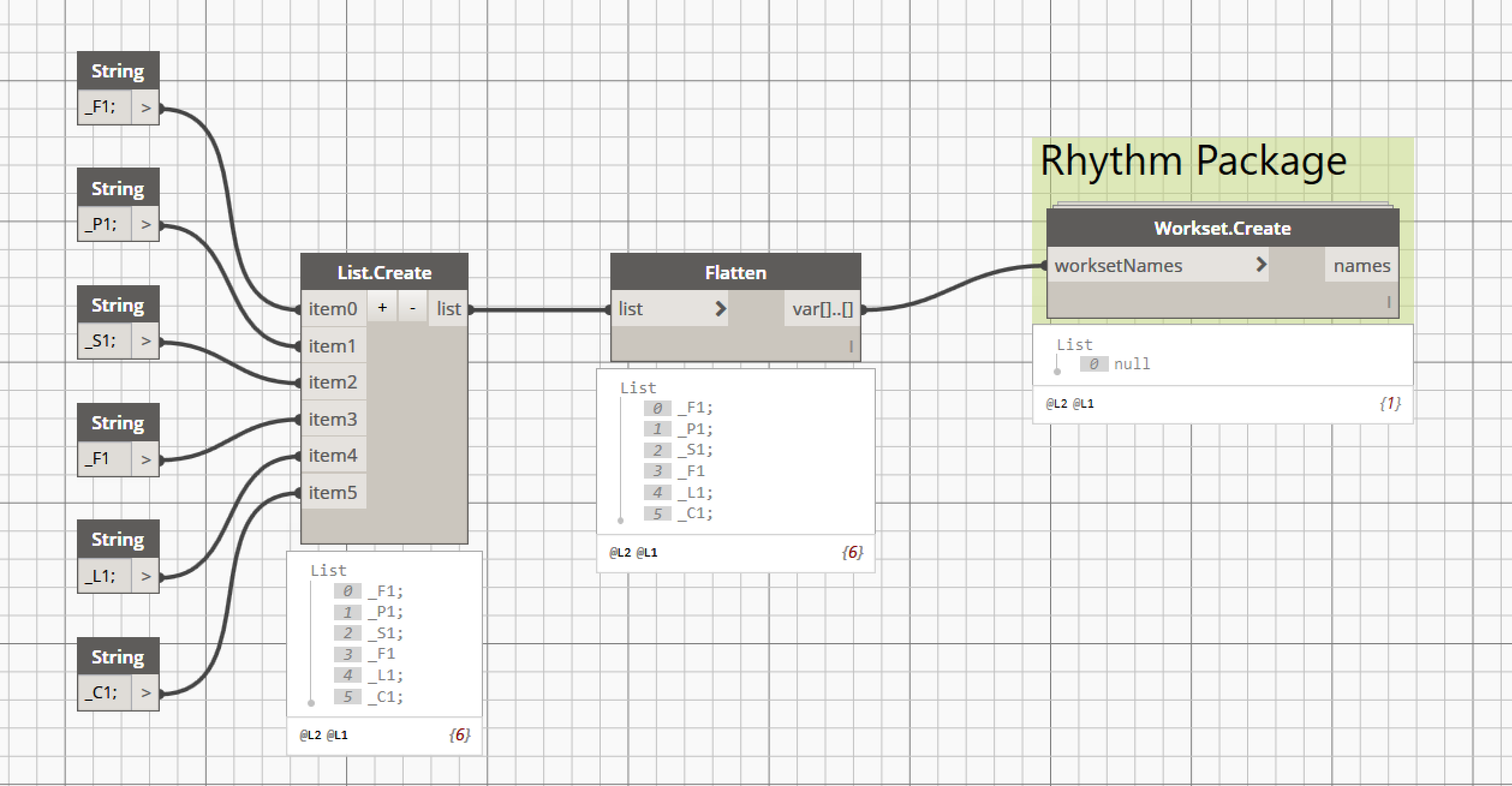

I am trying to create worksets for a work shared project. Did I do this right or am I missing anything here
I tried this on dynamo 1.3 and Revit 2016 / 2018.R2
Thanks in advance for the help

try to remove " ; " from the end of strings , use that just in code block
Tried it still nope
i have tried that, the problem is from underscore " _ " at the beginning of strings , remove it or start your string with something else

Thanks it worked.
