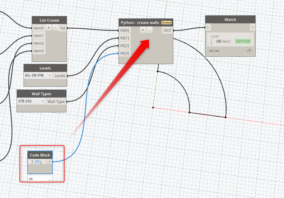

Hello Dynos,
I have some weard stuff:
My script put out meter (it should) when write 2.5 i makes the wall 25cm height, and even that is wrong it puts the value to 2.3226… a.s.o. why?
I´ve seen i can create a base-level, but how about a top-level? (instead of height) does anybody know a syntex? TopLevelId?

lines = IN[0]
level = UnwrapElement(IN[1])
type = UnwrapElement(IN[2])
height = UnitUtils.ConvertFromInternalUnits(IN[3],DisplayUnitType.DUT_METERS)
output = []
for i in lines:
wall = Wall.Create(doc,i.ToRevitType(),type.Id,level.Id,height,0,0,1)
output.append(wall)
OUT = output
