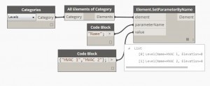

However, your intent isn’t clear to me. What exactly are you trying to achieve?
If you just need to rename levels, then try something like this…

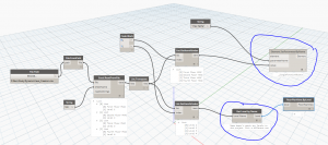

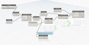

Sorry Swapnil-
The Get Levels by name node does not work on Lists. It only works on a single string to produce a single level. If you want to use it on a list of level names, you need to feed it through a list.map node. See attached. This will work to do what you want.
Hi Ben
I would like to view your image but I am unable to enlarge the file.
@cadman6735 Here is the clear image.
Thank you very much

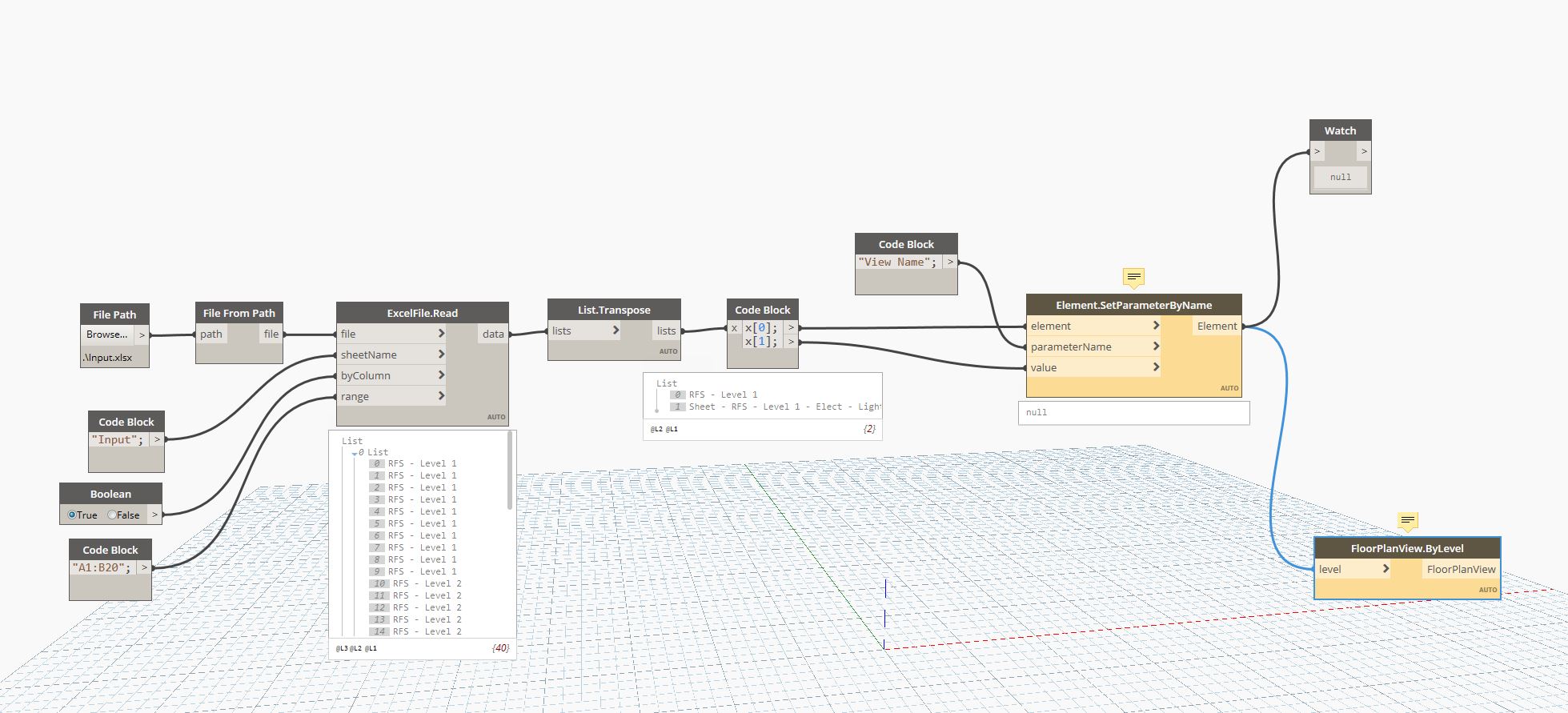

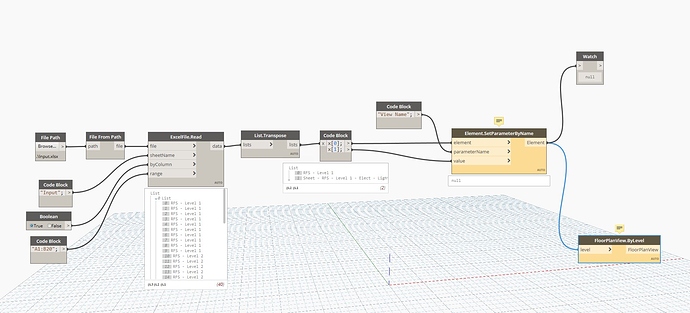

Hi everyone - I have been looking for something exactly like this, but I have had no luck with it running.
We are looking to create views based on copied/monitored levels and to change the View Name based on an excel file that looks similar to the following. Column A is the Level in Revit, Column B is the View Name and Colums C is the Template that I would like to associated with each respective level. The levels already exist, as do the Templates in the Revit file.
Any help is really appreciated. As of right now I seem to get stuck on the Element.SetParameterByName. Also, I stripped down the code to just try and get Views setup.
