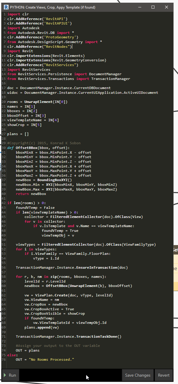

Had a GC decide to upgrade to Revit 2020 only to break a script. I am not good at Python at all and need some help solving this.
Here is the script
Create Room Drawing by Current Model Rooms or Spaces_2021.04.22.dyn (379.9 KB)
The script is meant to create a view from a room or space. Creates a plan view, 4 elevations and sheets.
The property ViewName is deprecated. Simply replace vw.ViewName by vw.Name at line 63.
Thank you so much! I appreciate the quick response.
