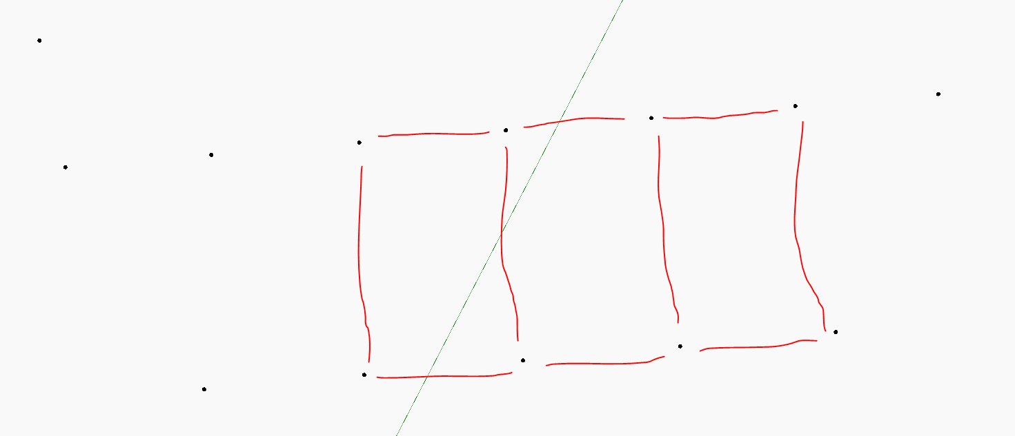

I have two lists of points, and I would like to create list of polygons out of them.
I tried creating a surface for the exterior boundary and split it using curves along, but it didn’t work.
So my idea is to chop the list of points into 4 points sublists and create small polygons, boundaries…etc and create surfaces out of it.
Could you help please?
Polygons from points.dyn (42.2 KB)
Something similar to this
