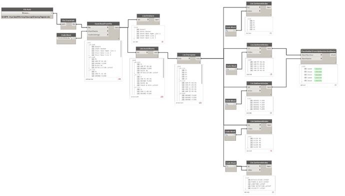

Hi, i am trying to create placeholder sheets using a excel spreadsheet which references both built-in parameters and shared parameters. i am managing to create the lists to extract the data from the spreadsheet but i am struggling to write the information back into Revit.
I have used the PlaceholderSheet.ByNumbersAndName Node and tried to edit the custom node to include additional shared parameters but my limited python scripting is not helping.

Hi @salvatoredragotta,
With some further investigation and looking at various threads, i managed to create the following script.
It Extracts the columns and data from Excel, creates the placeholder sheets then it filters, sorts and update the shared parameters.
You run will include errors because of NULL VALUES.

Here is an example. Add more columns and set their names to the parameter names, ensuring they are applied as project parameters to sheets before running the script. I’m not sure why the script is creating shared parameters, you are better off making sure your template has all needed parameters already instead.
The two custom nodes are from Crumple.
Generally tutorials can only get you so far. If your workflow becomes more bespoke in nature, you will be less likely to find that part covered.
