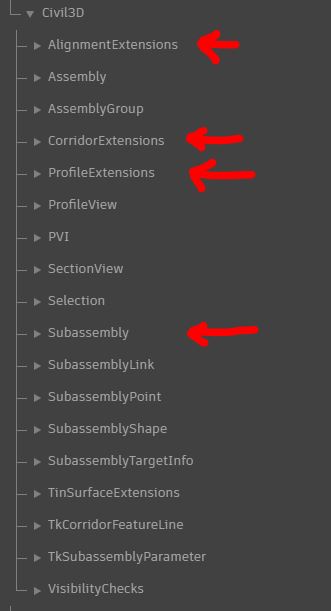

But if you don’t require Civil 3D intersections, then you should be able to work something out with the Civil 3D Toolkit package.
