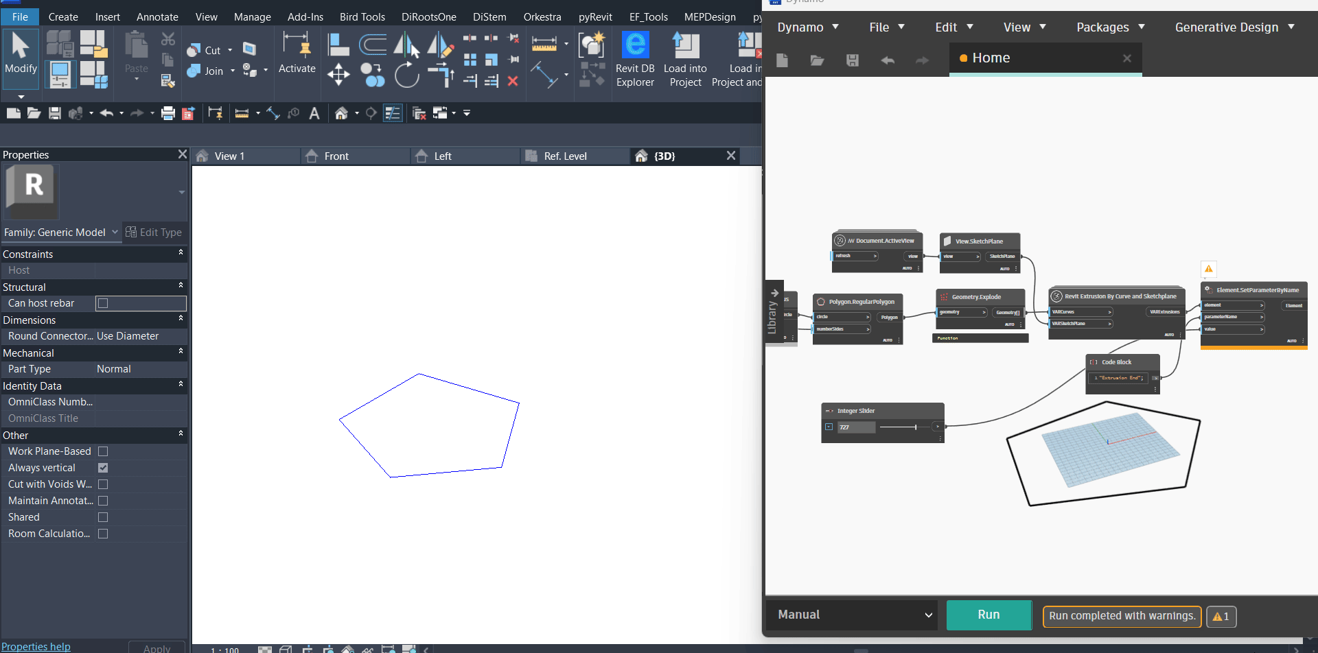

is it something here you mean ?
Revit_OYfPJcIE0t
Thanks for the insights. looks solid. hard to see the actual nodes and/or packages, could you post the script and possible packages?.
that one is from synthezise toolkit
Home.dyn (14.6 KB)

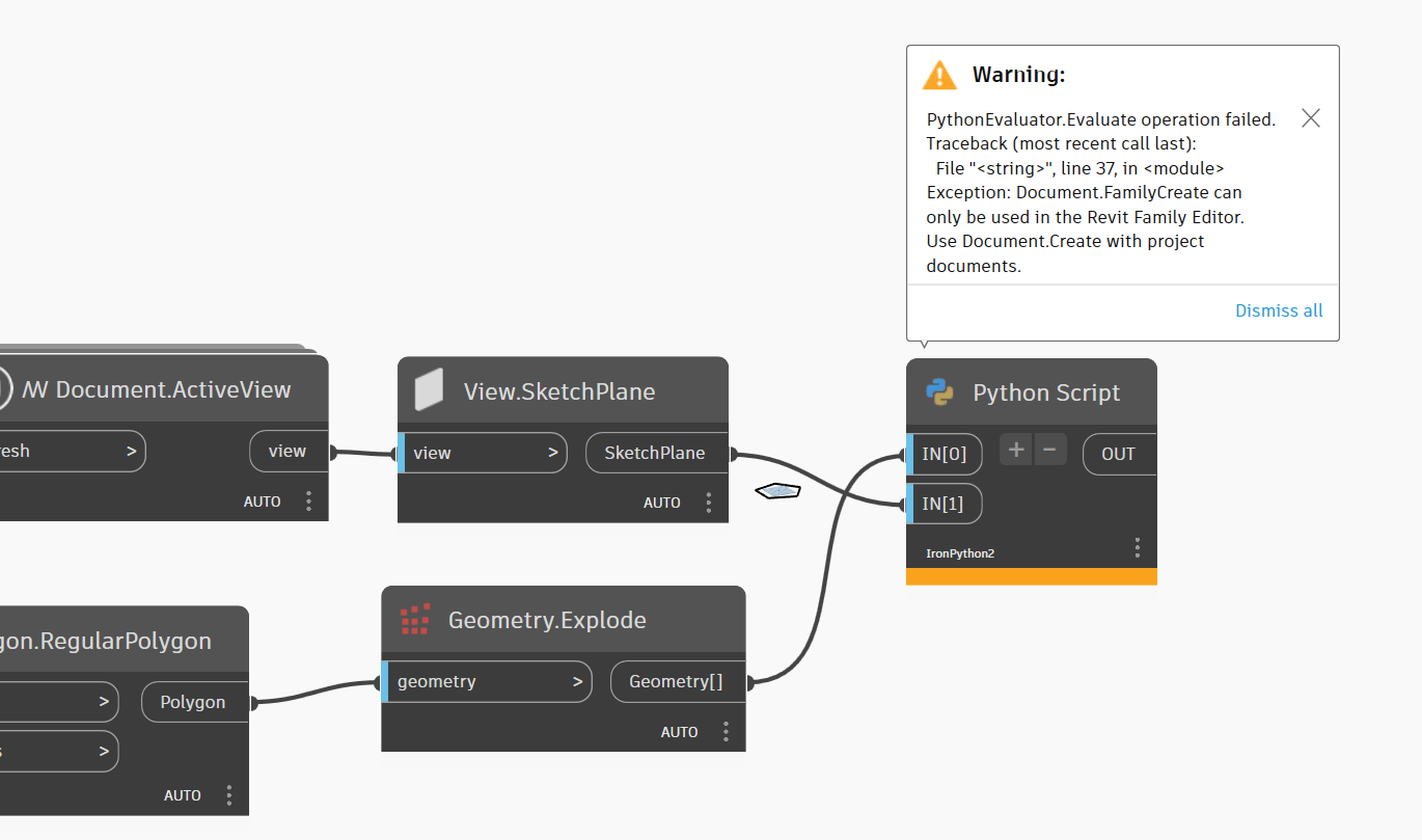

Hello, I tried your example and I kept on getting this error message. Do you know how can I solve it?
Hi are you sure you are in a family document ?
