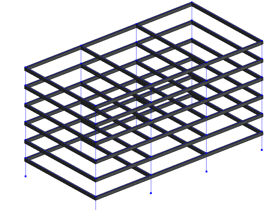

I try to create differents floors according to my number slider.
Levels are already created.
My building is a rectangle, and i have points at every 4 angles, but these angles are in a list and Floor.ByOutlineTypeAndLevel doesn’t accept lists…

I didn’t see the node in your definition.
Anyway, Floor.ByOutlineTypeAndLevel needs curves for the outline as the name of the input discreetly suggests:
I planned to join the line created to make beams to use Floor.ByOutlineTypeAndLevel
Something like this?
Yes !
Thank you !!!
