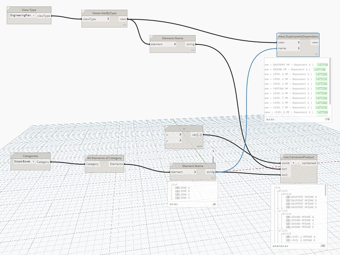

I am trying to create dependant views of my floor plans using the scope boxes i have made in Revit. The script is most of the way there, but something abnormal is happening when creating the dependants.
Instead of taking all views and creating 4 dependants (Zone A/B/C/D) Revit is creating 2 dependants for each view, Basement 1 contains a Zone A scope box, Ground floor contains Zone B, Level 1 contains zone C etc. and all the rest of the floors just contain 2 dependants, named “dependant 1” and “dependant 2”. I’m sure it’s an easy fix, i thought it may be the lacing but ive changed that and it doesnt help. Any ideas?
