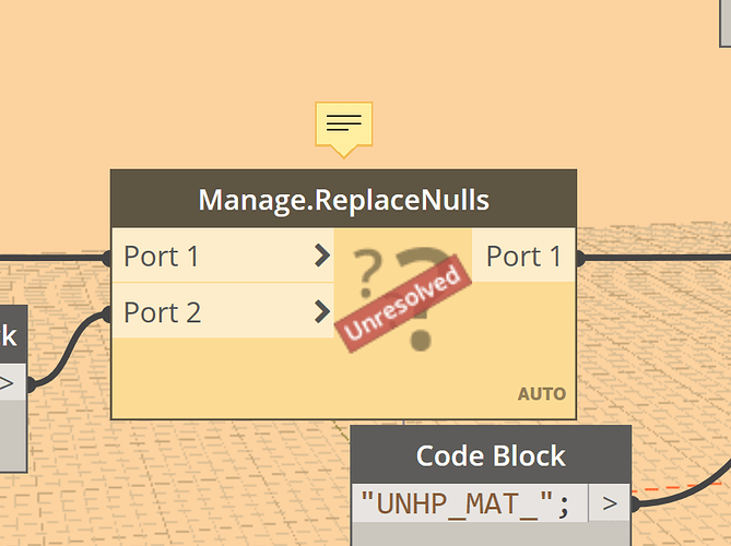

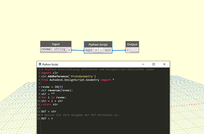

I cant manage my packagefolder, the packages erase each other. So i desided to make a costom node
for “Slice String” but how?

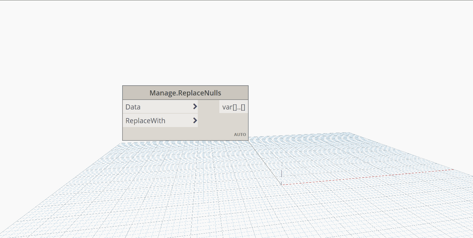

package Manage.replaceNulls i think it is Lunchbox?

Andreas Split.String_costum.dyf (4.9 KB)

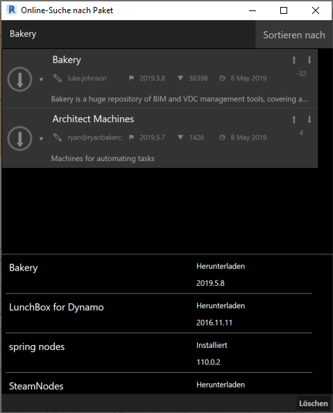

it is not showing it i use 2.0.3. i have still problems with installing packages f.e. when i install Bakery it installs automaticly Lunchbox, Archi-lab, Clockwork 1.x …
Thats a part in dynamo which i don`t like, even the installing instabil!
Lunchbox is 2016. i think it should be newer!
Lunchbox isn’t installed trough the package manager anymore. https://provingground.io/tools/lunchbox/

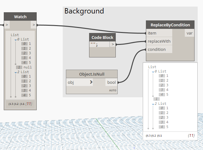

For replacing nulls, it can be done with OOTB nodes.
