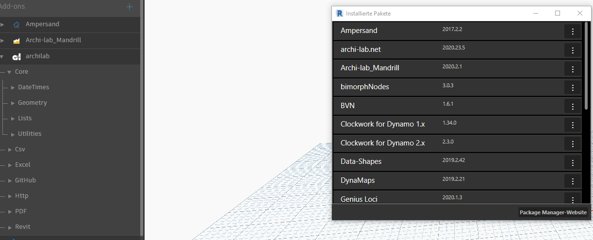

I have already installed archilab but I can’t see it… Which version of Archilab do you have?

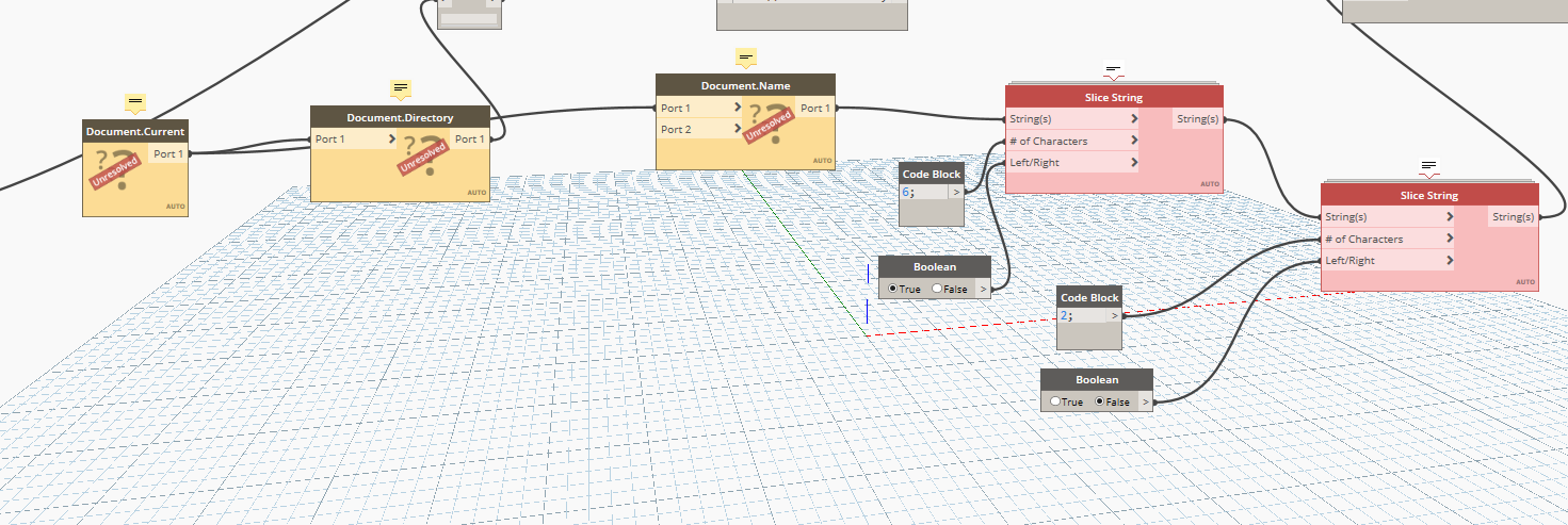

Slice String is not missing (it does not have the “Unresolved” tag) it fails as it gets “null” as input…
That said I’d download Clockwork and Orchid as part of your standard setup.
Orchid has nodes for both Document.Current and Document.Name as well, new versions might also have Document.Directory

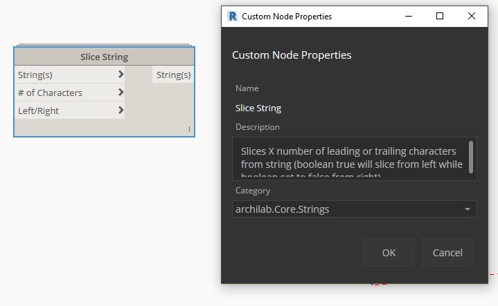

Also the way to Slice string is:
Archilab -> Core -> Strings -> Slice String
Orchid package, as you said had been updated. I deleted nodes and created again. It worked. Archi-lab does not have any Slice String node. I have 2020.23.5 version of Archi-lab.net. It is not problem, because I created a Python node instead of it.
I use Revit 2019.2. Should I use the version which starts with 2019?

The problem was: I should have installed the correct version of archilab for Dynamo 2.0.3 (2019.2.27)
