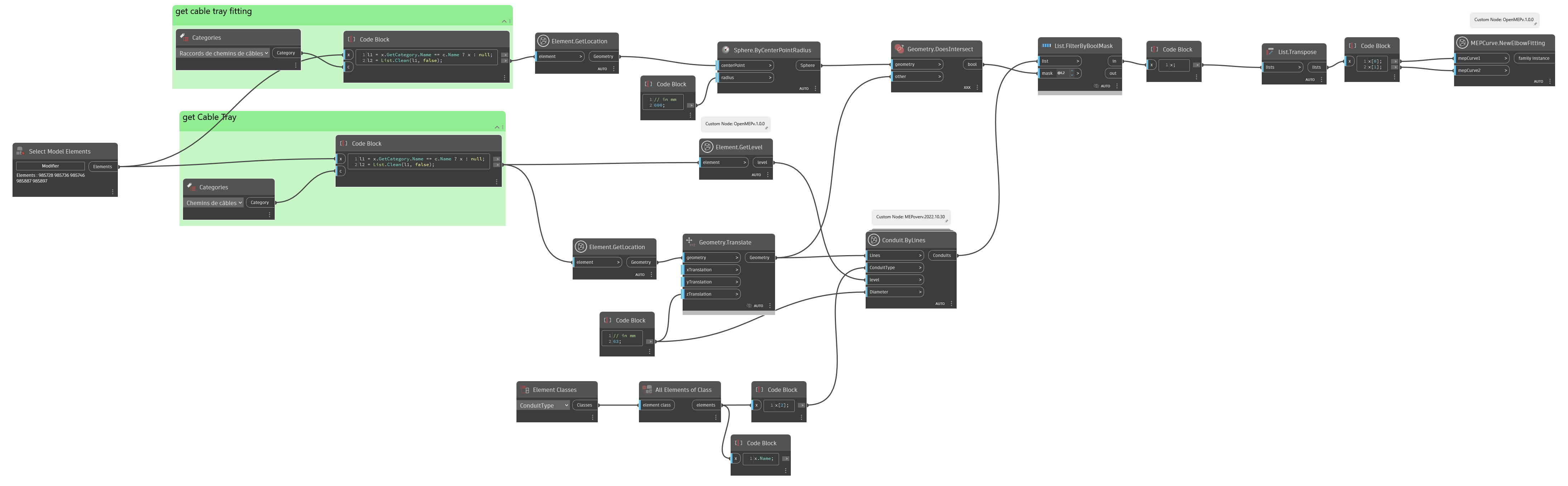

once pipes are created
  • get all cableTray fitting
  • for each cableTray fitting, find the group of nearest pipes
    → for each group of nearest pipes, create pipe fitting (elbow or Tee)
Thanks for your help
Hi @c.poupin can you please explain me how to use those nodes ? thanks in advance
here an example
