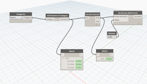

Hi everyone,
I have an idea of auto generate 3D views for each room by their ID. But I can only generated 1 room 3D view at 1 time and with the same View name.
Does anyone have an idea on this case?
Thank you.

Have you tried putting the “all elements of category” node directly into the section box without the list deconstruct because the list deconstruct is only giving you the first element and will be the reason you are only getting 1 view.
