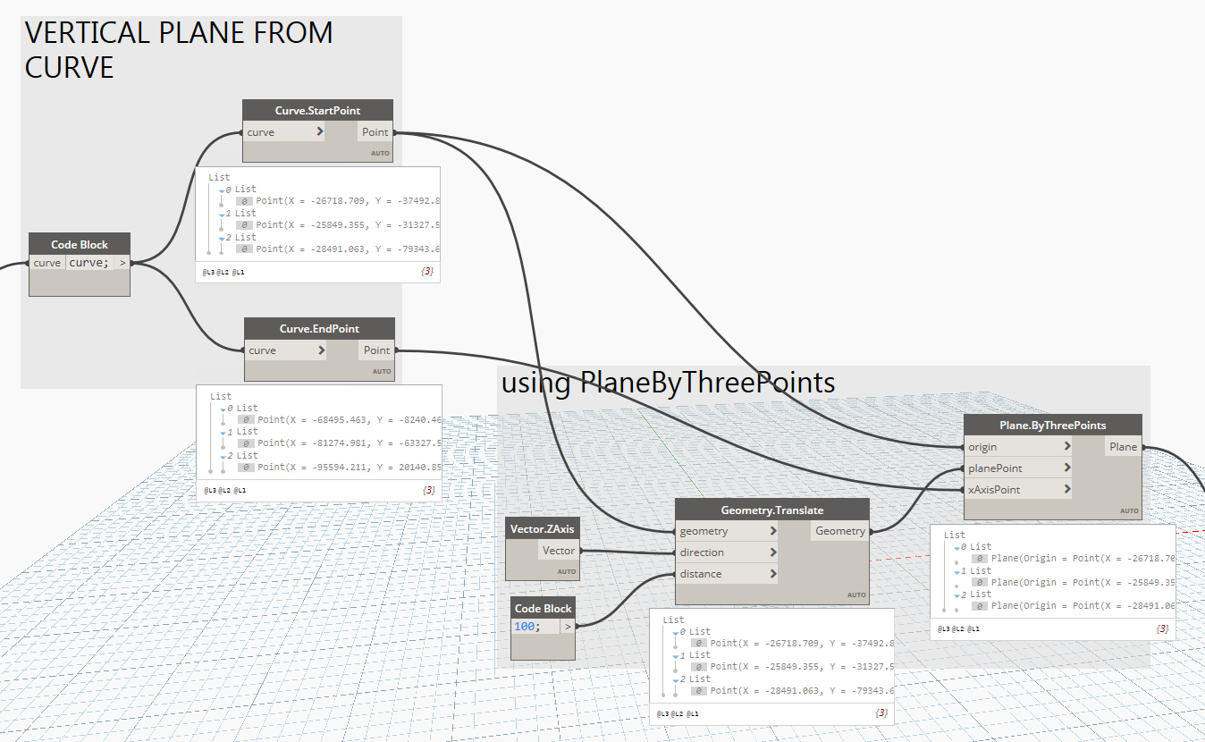

I am trying to create a vertical plane from a curve, by using plane.bythreepoints.
Somehow I get this error that I do not understand:
“Could not create plane - desired axes are parallel”
Please see the screenshots. I have no idea what is going wrong.
The curves are drawn on a horizontal workplane, so completely flat.
Any ideas for help please?
curves: (top view)

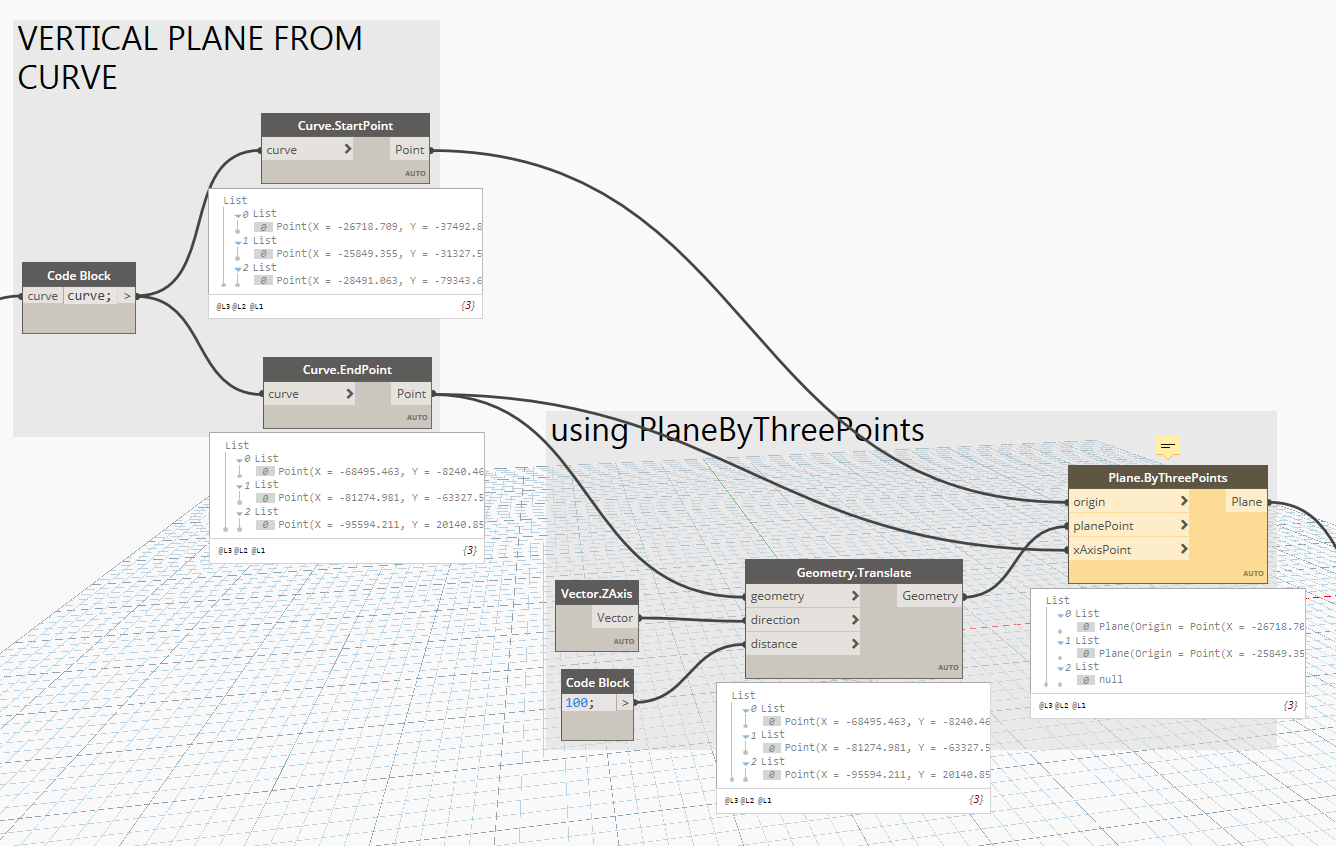

Can you expand the previews for the nodes and re-post another screen snip?

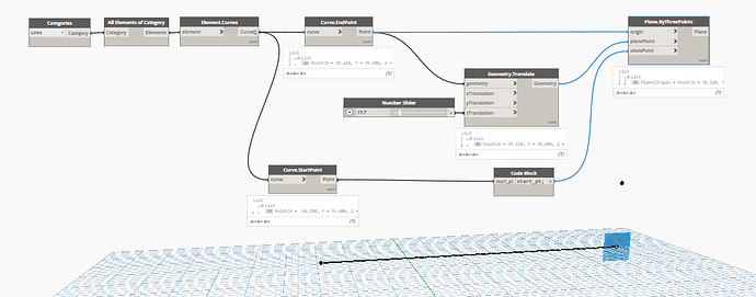

What you’ve already done should work…in any case I’ve tested this method and it works as well:
vertical plane.dyn (15.1 KB)
Edit: I think your error message implies that you’re taking a vertical curve, translating its endpoint, and then trying to create a plane from 3 points which exist on the same Z-axis.
Thanks for your responses so far.
I have solved it, but I don’t completely understand why.
There is a difference if you send the translated startpoint as planePoint, or if you send the translated endpoint as planePoint.
I don’t understand why this matters. Do you?
It’s hard to tell what is exactly happening without knowing the Z coordinate of each of the points. 2/3 of your planes were successfully created, so it must be something specific to the last curve that is making the plane creation fail.
