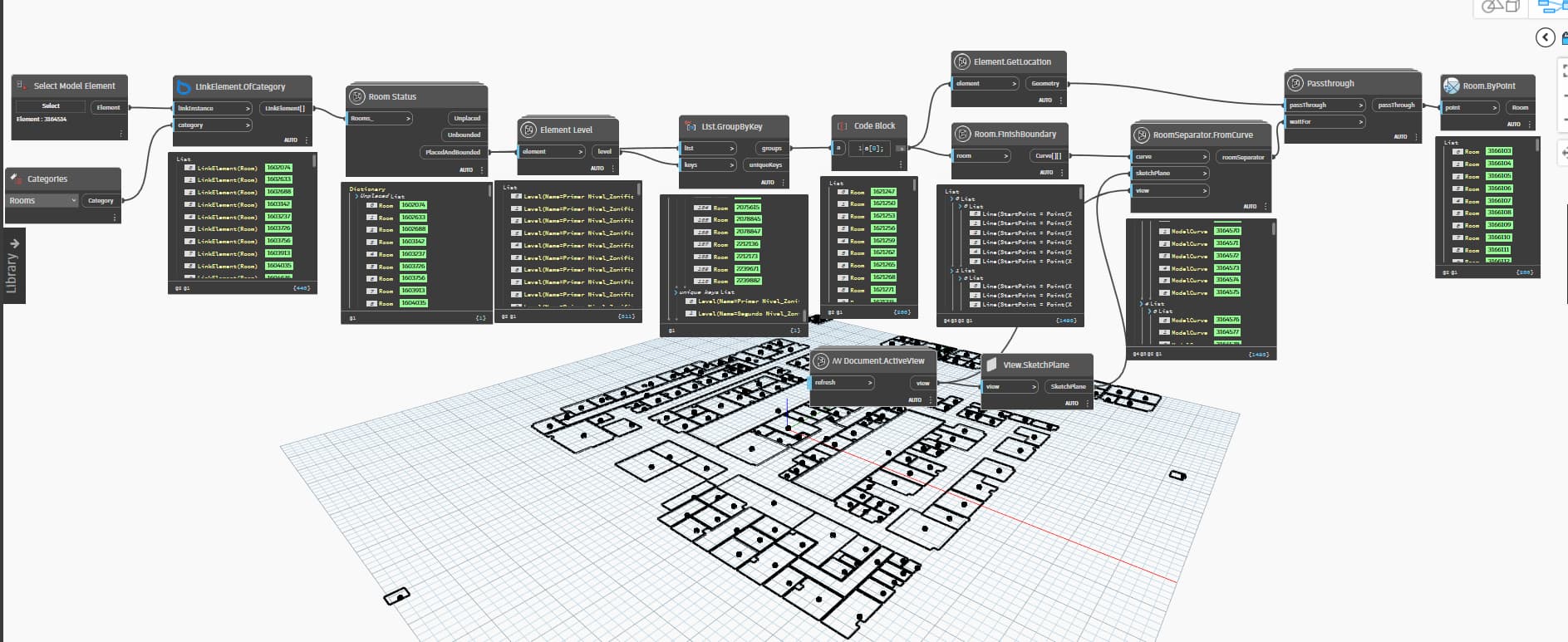

Hello, when I run this script I am getting an error with the “Element.GetLocation” & the “Room.FinishBoundry” nodes. Do you have any thoughts on why?
copiar elementos entre links.dyn (30.2 KB)
maybe trying with this one, may help?
Hi @MshookS2B9L try feed in the room and not the levels
