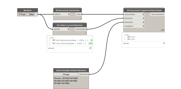

I am trying to copy dimensions from one plan into an RCP and the slab plan by selecting those views from the project browser. Would anyone know if I need to use different levels or if I may need a different node?
I’ve used this post as a base, so the graph works with the bool mask node but not the Collector.CurrentSelection.
