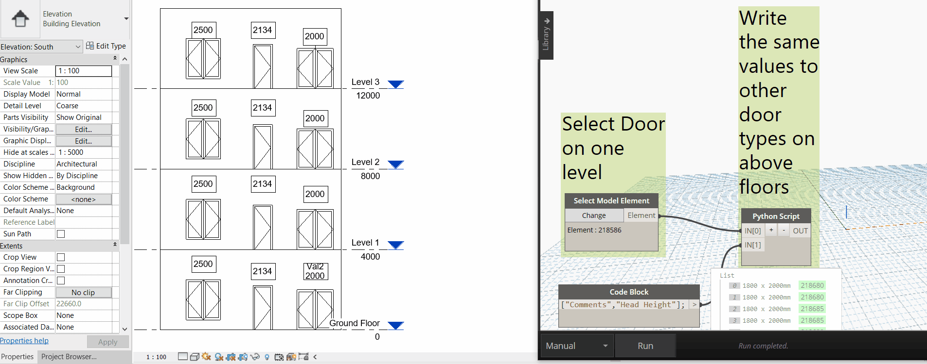

Copy data from one door to many door with same name
thanks Daan for your time i can wait you until you are free because i make all tricks to solve this issue but i can’t solve it :disappointed_relieved: :disappointed_relieved:
Hi @sarah.9090

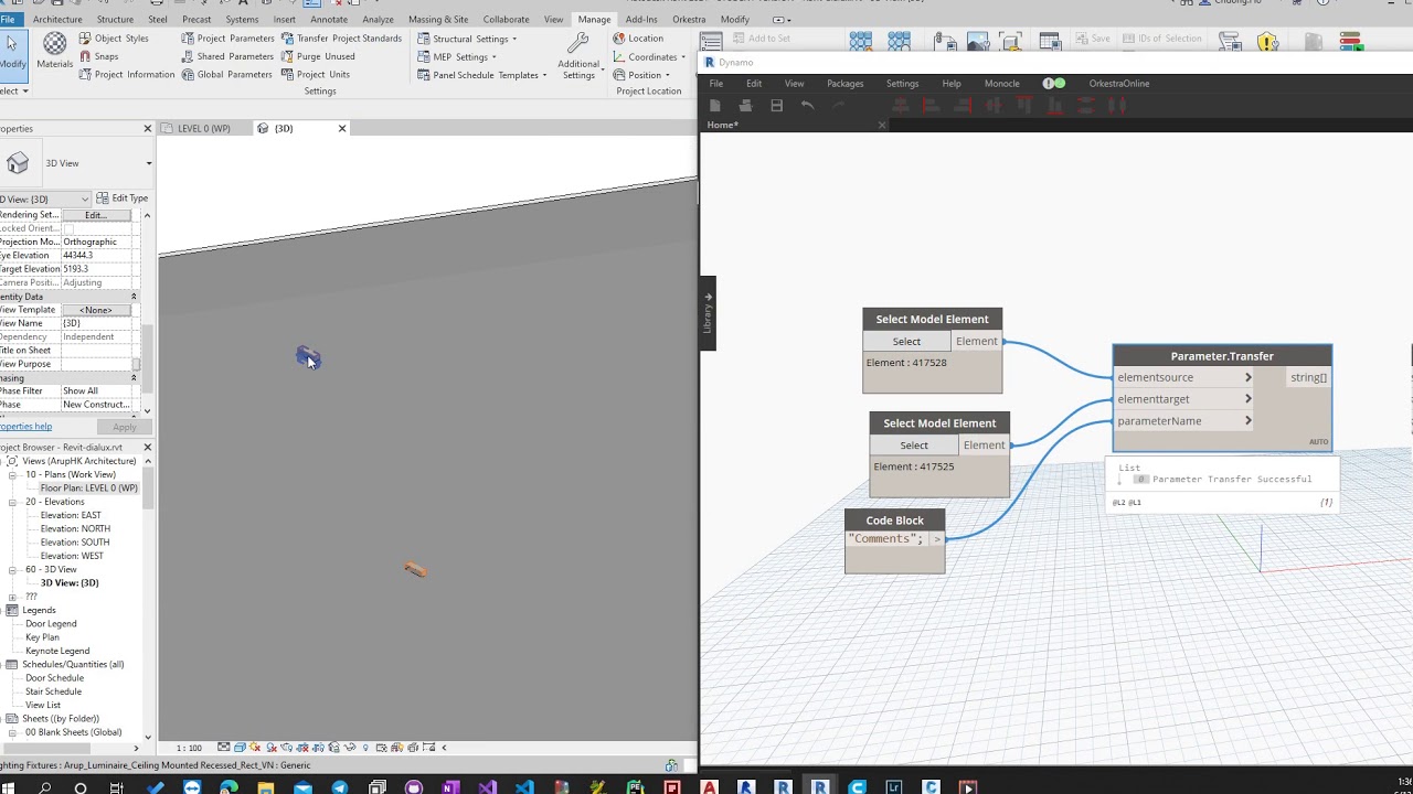

Is this what you’re trying to do?
I Am so happy, Thanks @Kulkul For your efforts and your help you always save my day :heart:

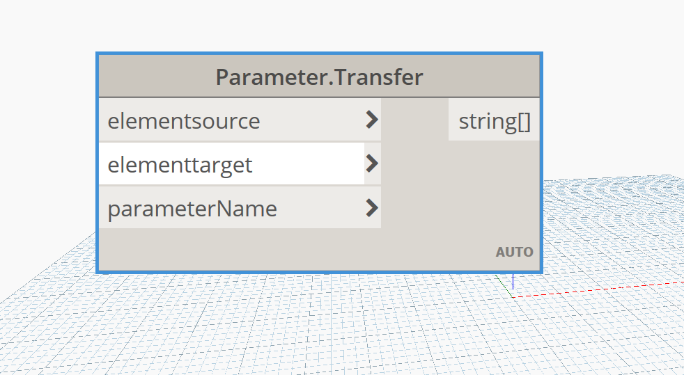

can use Node this in Package DynaMEP and lacing longest
i can’t find it ??
You can seach in Dynamep.Revitmodel.Parameter

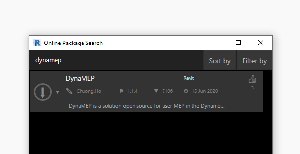

where i can search i search in google and in dynamo and in dynamo packages ??
You can seach in Dynamo Package image
ok i download it and i didn’t find the node
You have Install Version newest ?
yes i do
great node where can i find it ???

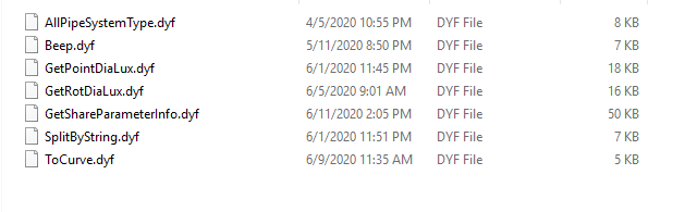

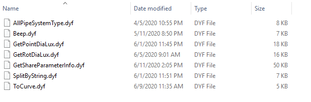

you see the node not inside the file you shar to or in the dynamo server
File create with dll, Please see in folder name bin and open in dynamo Revit.It suport Version dynamo 2.0 over
