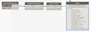

You can extract all the instance parameters of that element with the “Element.Parameters” node. That will give you parameter elements, so you’ll have to extract the name of the parameter from that with either “Element.Name” or with some string management. Once you have those, you should be able to proceed as usual with the Get/Set nodes.
Some problems that I see with this work flow is that some of the parameters are read-only and that will lead to a few errors. You might also get a lot of duplicate mark errors.

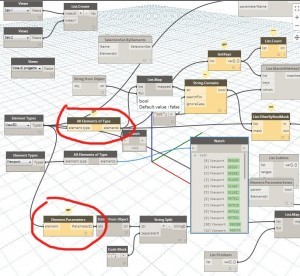

I would have loved to use this parameter query with a 3dView, but since it is a familySystem, it won`t work. What else I could use to select all the 3dview from a Revit document, then filter them…?3dViews-select
another work around could be select, family elements within the project by a project parameter.
However when I use the node Element.parameters from the family type node, they would not get picked…any hints
P.s. ( Seats are divided in group, by a parameter field related to the level in order to let me to schedule them- they are the 2000 seats…)

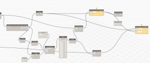

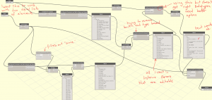

This is still not really working for me. I am trying to take two equal length lists of elements, and copy all of the Instance writeable parameters from one to the other. I would have thought it would be relatively easy in Dynamo :slight_smile: Anyway, please see below for my progress. My first problem is that I can only seem to get it to work on one Element at a time, when I try to expand to a list of elements various things don’t work (like the Clockwork ReadOnly check). No doubt this is because I don’t understand how to Map things properly when I have a list of Elements, and sublists of Parameters… The other thing that isn’t working is the GetParameter node - as a workaround to the 0.8 issue, the one I am using successfully gets values as Strings, but obviously this doesn’t really work because I can’t push Length and Yes/No values into the target element (because they are strings).
I appreciate any thoughts you may have. Thanks!
copy parameters node
This tactic over here http://dynamobim.com/forums/topic/applying-parameter-values-through-nested-lists/ actually helped. Still have some errors but it is progressing.

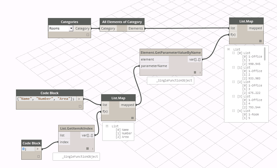

Hi Luke, you cannot directly pass a list for input port parameterName. You have to use a List.Map node or a series of them to process lists when nodes don’t accept lists (have I said “lists” enough times?!). It would be fantastic to have nodes that accept both; Dynamo would be so much more user friendly.
Anyway, here’s what you need to do I think. In this example I have a list of objects (Rooms) and a list of parameters I want to retrieve. Basically the function just gets more complex and you nest other List.Map nodes as required. Hope I’m explaining this correctly and it helps in some way.
Mapping
Or…2015-05-08_16h29_04

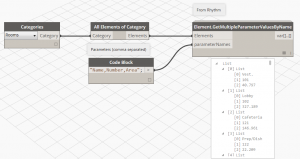

Hey John , I can’t see the node Element.Getmultipleparametervalue ? is it no longer there in 0.8 ?

Hi Alferdo,
For your first question, see graph below, Regarding managing Avatar work is under progress. Good Luck!

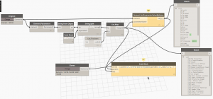

Well, thanks to this forum, I learned about the usefulness of custom packages. I loaded “Rythm”, and it contained the 2 nodes that solved the problem that I was describing above. Here I am sharing the solution: Change Description Parameter Text to UpperCase or LowerCase Change Description Parameter Text to UpperCase or LowerCase
