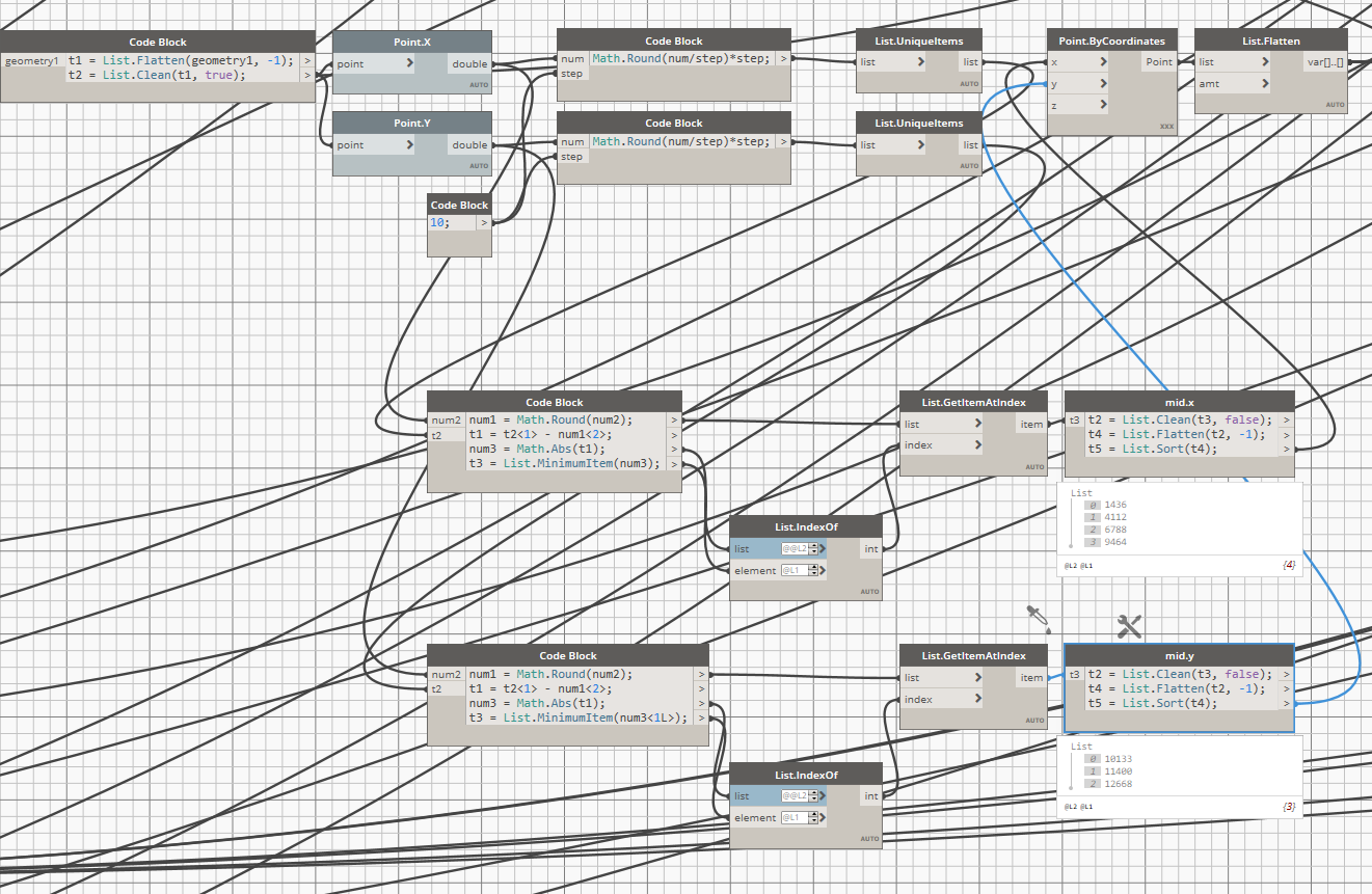

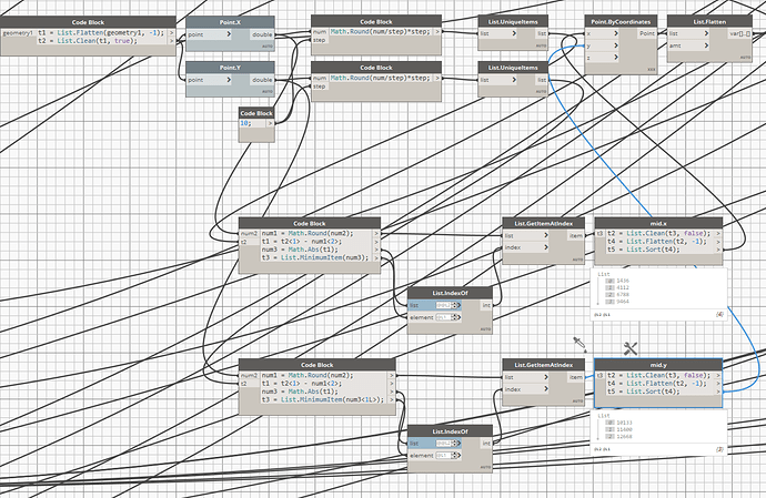

I’ve been creating a script to get the midpoints of fixtures which are placed in 3x4 arrangement.
So, I changeed the fixtures(elements) to boundingbox and get midpoints then used Math.round - Uniqueitems to not get extra values. But even though the fixtures are on the same x, y value in Revit, it still has different values after I run my Dynamo codes. Is there any solution to round and get the correct unique values?

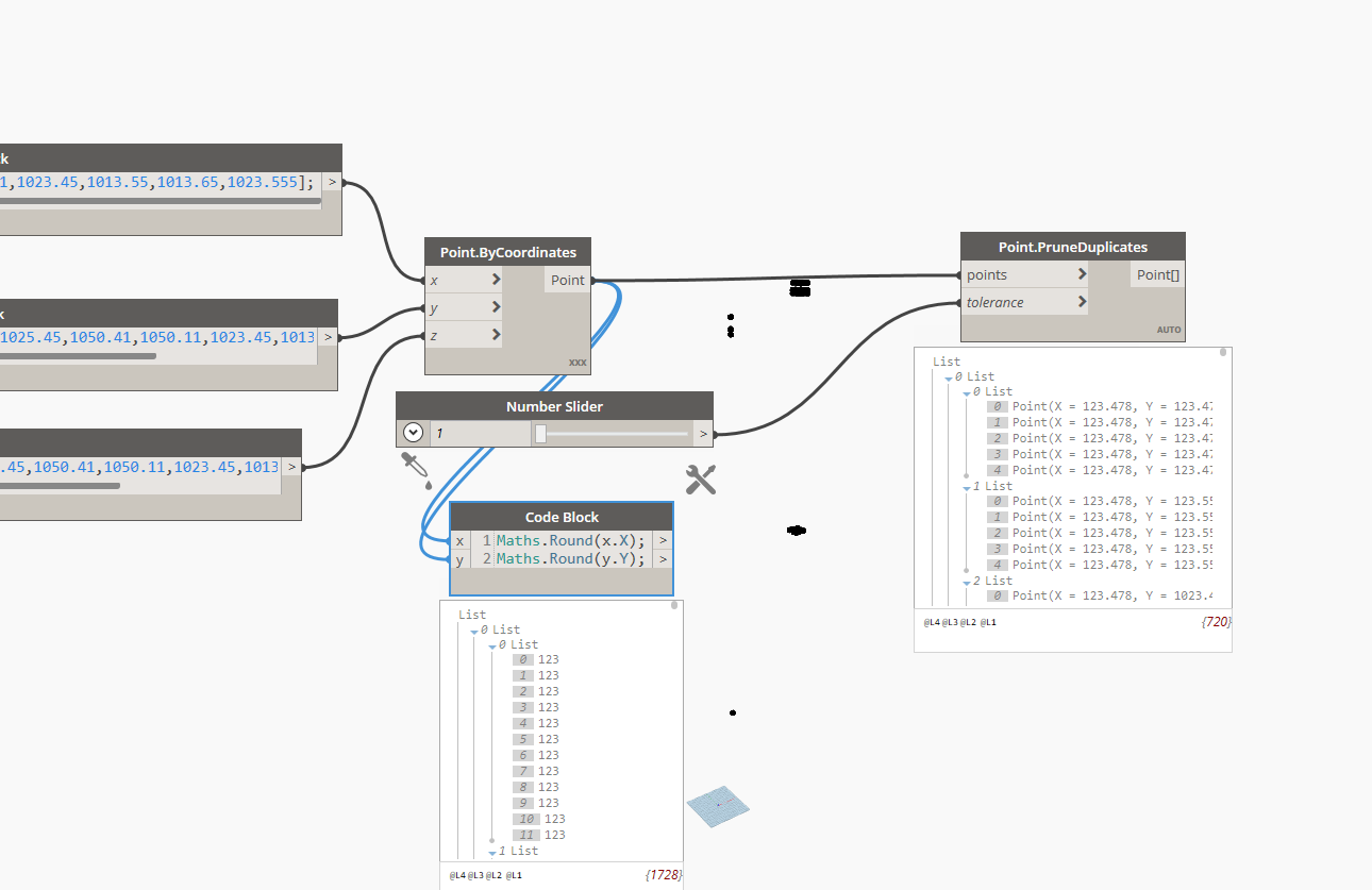

Hello @jaeho …have you tried prune duplicates
Hi, @sovitek What do I need to put into tolerance when I use the Point.PruneDuplicates node?
For example I want to get only 3 numbers from point. Y but there are still 6 numbers in the result
@jaeho ,
he takes from each point the coordiantes x.X, y.Y ! can you play with the tolarance via slider?
