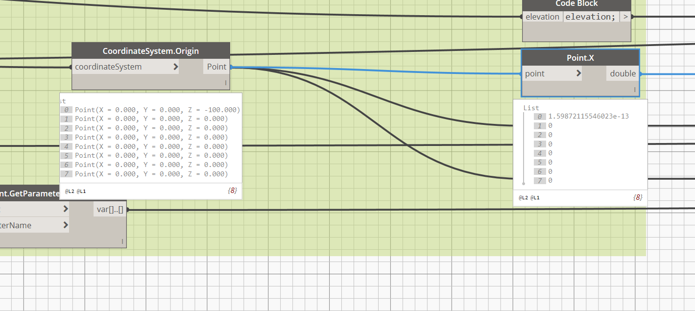

I am grabbing all instances of Revit Links, then their coordinate system origins as a point and comparing to the Internal Point. The CoordinateSystem.Origin point is correct, though when I attempt to extract X,Y,Z to compare, I receive a very odd error. See screenshot below. Has anyone experienced this?
BTW the error is coming across in the [0] item. Tried to refresh the results and run again, with the same error being produced.
Peculiar. I am in SI and the other 7 instances available in that same list all exist in an SI world.
I’ve added a Math.Round after the Point.X node and receiving a 0 as a result.
I’ve also noticed that True North shows in Revit at a 90 degree angle, but reports in Dynamo at 89.99999 etc.
Maybe comparing “close” numbers here is in store.
