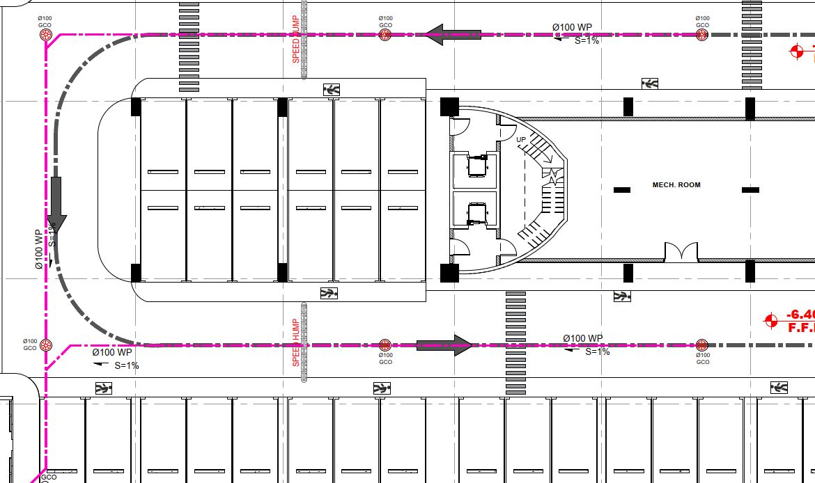

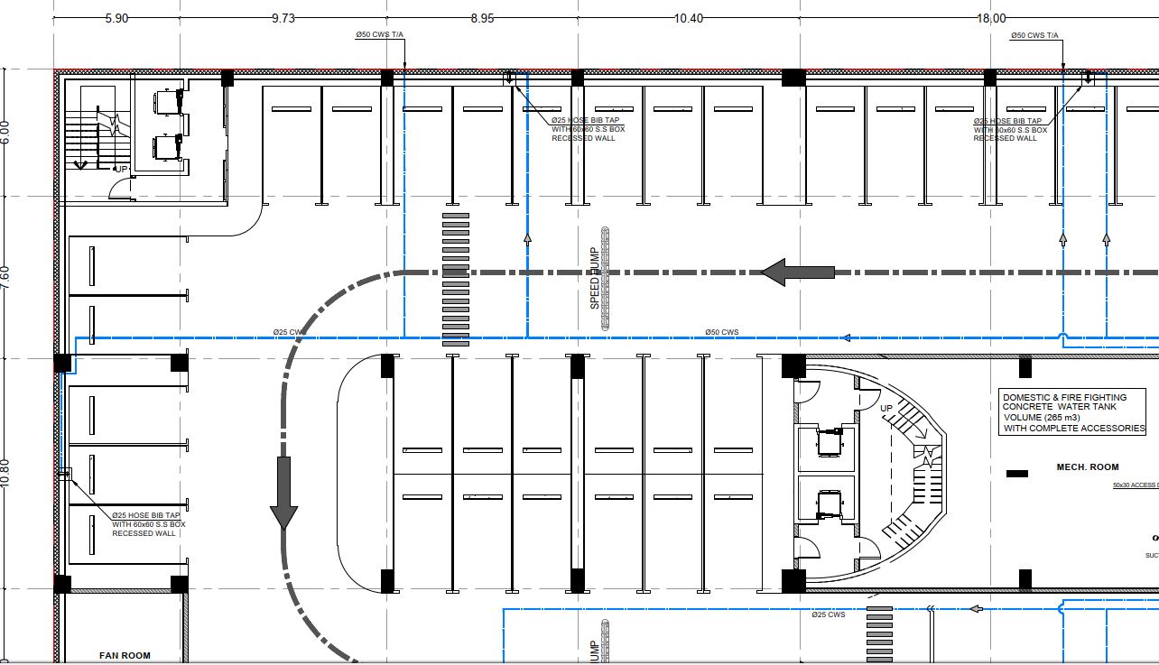

I want a dynamo script to convert 2d autocad lines to 3d Revit models for MEP work
These are my drawings and I need to create a 3d model matching all of these but I don’t have much time to do all, so I want a dynamo script that makes it easy and short time for me

but still, I need to connect the pipes to each other, adjust the levels, and resize the pipes automatically in the network, especially for fire and water
That’s what we needed to see. Yes, you’ll need a good bit more as this will just give you pipes. And with the CAD file being flat (I assume.) There is a lot of adjustment to be done for heights and slopes. You might be better off breaking those tasks down into separate scripts. I think you would have to set the height of the sprinkler heads and work back from there with the slopes.
