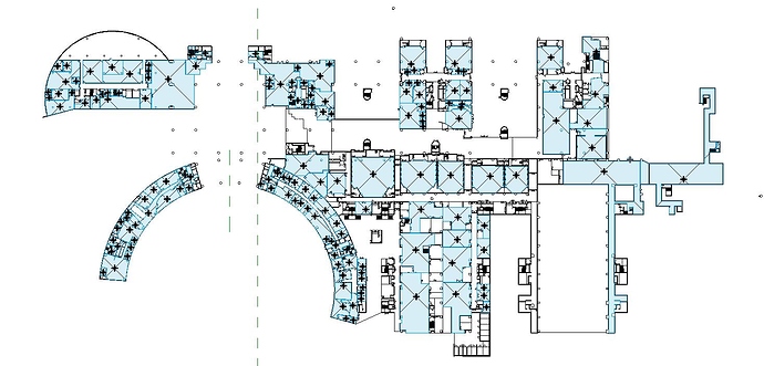

Convert rooms to mass: trim_with_edge_loops requires all curves to touch surface dynamo
Hi everyone! I am converting rooms into masses using dynamo. After completing running, some masses have been created successfully but some failed. And there is a warning called trim_with_edge_loops requires all curves to touch surface dynamo. I found that the number of the output list is less than that of rooms defined. Is there something wrong? Here are the screenshots and dyn file. Thank you!
room_to_mass.dyn (240.4 KB) Warned element outputs Warning message
Maybe use the boundaries of the rooms that give you trouble like this one
If your room has a hole in it, it might fail.

The room you marked does has a hole inside it. But for those that don’t have holes, it still fails…Can you tell what may be the problems? Is this dynamo file ok?

Hi, I tried your suggested idea but the problem still remains. Here is the model. It exceeds the size limit so I uploaded it in google drive here. https://drive.google.com/open?id=1HLeCXph6KaZpGU2PqeK3qG0FB-Ay54Ri Could you run it and see what are the problems? Thank you!
There are 55 rooms processed in the file you send, which can be converted into “Solid”.
