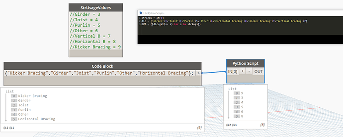

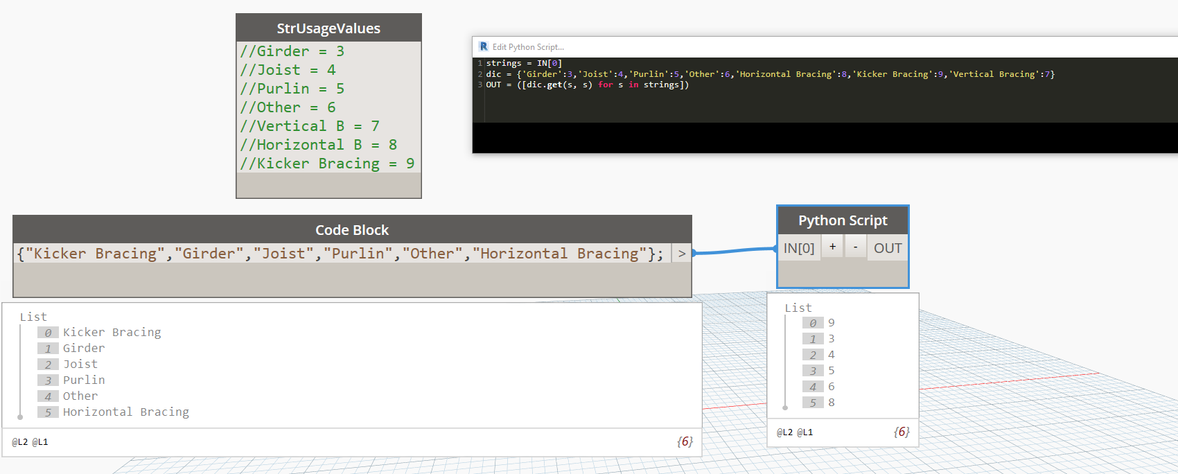

Here is one of the better way with just few lines of python :slight_smile: :
Great thanks, this is the idea I was looking for but couldn’t find it in a search and haven’t dove into python language yet…just copy and pasting.
I have seemed to get it to work for a list of values; however, I will be feeding a single value through.
@dillon_manning Add List.Create node before python script that would work for you.

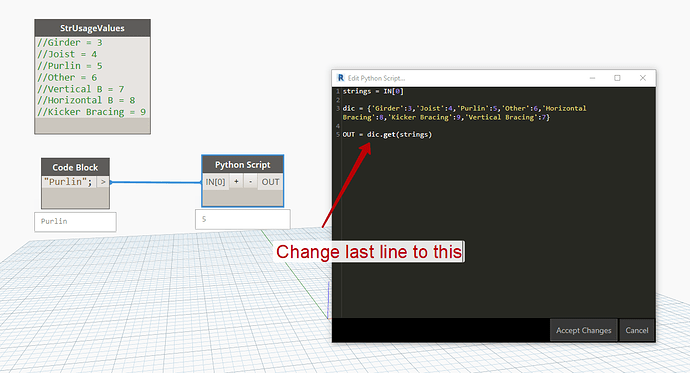

So we must not be on the same page haha. I’m not trying to feed a list through, I am trying to feed a single value which produces a single result (If the input is ‘Girder’, the output is ‘3’ and so on).
This works but I would really like to use python if it means avoiding a packaged node, thanks for the tip!
@dillon_manning You can just change the last line as shown below:
