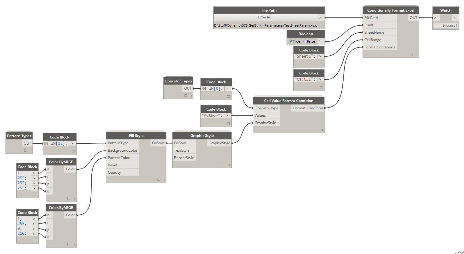

Hi all,
I am trying to format one range of my Excel with one Format condition. The Dynamo node returns “Success !” but nothing is happening in Excel.
What am I doing wrong?
Here is what I did:
Thanks for your help

Use Background Color not the Pattern Color. You are using a solid fill. Solid fill is applied to background, not the pattern lines.
If you used diagonal lines then you need to specify the pattern color (line color), and optionally a background color.
Thanks @Konrad_K_Sobon,
But still not working :s
Try it exactly like in my image. No FilePath input, keep the excel file open. It might be a FilePath issue.
It works !! Thanks @Konrad_K_Sobon It was a FilePath issue as you said :slight_smile:
