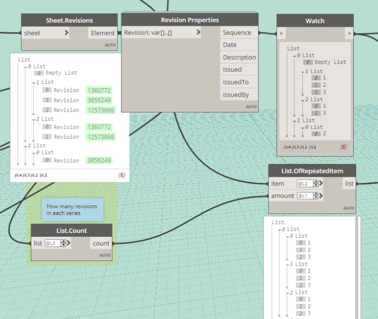

How are you getting the list on the right? There may be a way to get that data in the format you’re looking for rather than checking it against another list.

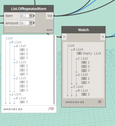

The List.OfRepeatedItem is done pretty much the same way but I filtered out duplicates first.

I’m still not sure why you need to compare the sheet revisions to the list of all available revisions. Is the goal to have Excel list the unique sheets, revisions, and dates in a series? Or is each sheet going to list all of its revisions and dates separately?
Will you always start at A and progress for the number of revisions in that series or is that just a placeholder? The reason I ask is that both series in your example start at A but the dates don’t match. Is it an option to show all revisions in excel and still only mark the ones for that series or do you have to limit yourself to only the ones in that revision?
The first issue will always be A (like on the Revit drawing sheet) but A isn’t necessarily in the first column. It just happens to be on all of the above.
Drawing 1 could be issued on a new date and then the first time it’s issued it would have ‘A’ in that column against it’s name.
I was trying to do this without resorting to python, but a lot of the issues you’re running into are because of your list structure. Most nodes aren’t meant to work this way within specific levels of multi-level sublists. The empty list doesn’t help either.
