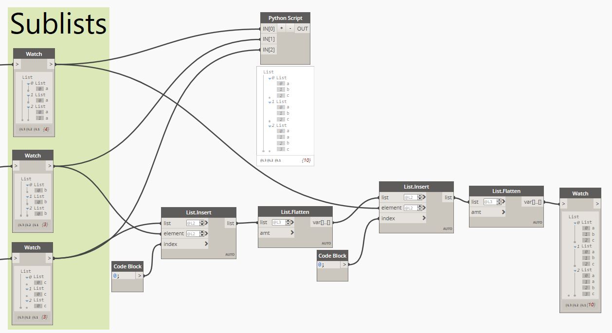

@Pierre_mplus you could use List.Insert with levels. Although it might require some use of flatten to get the desired output.
Alternatively, you could do some python coding to make the graph more compact.

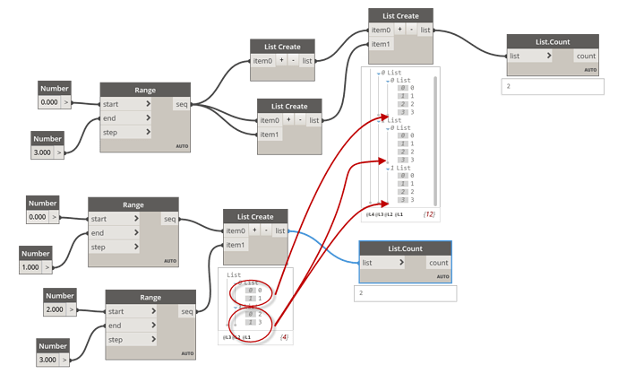

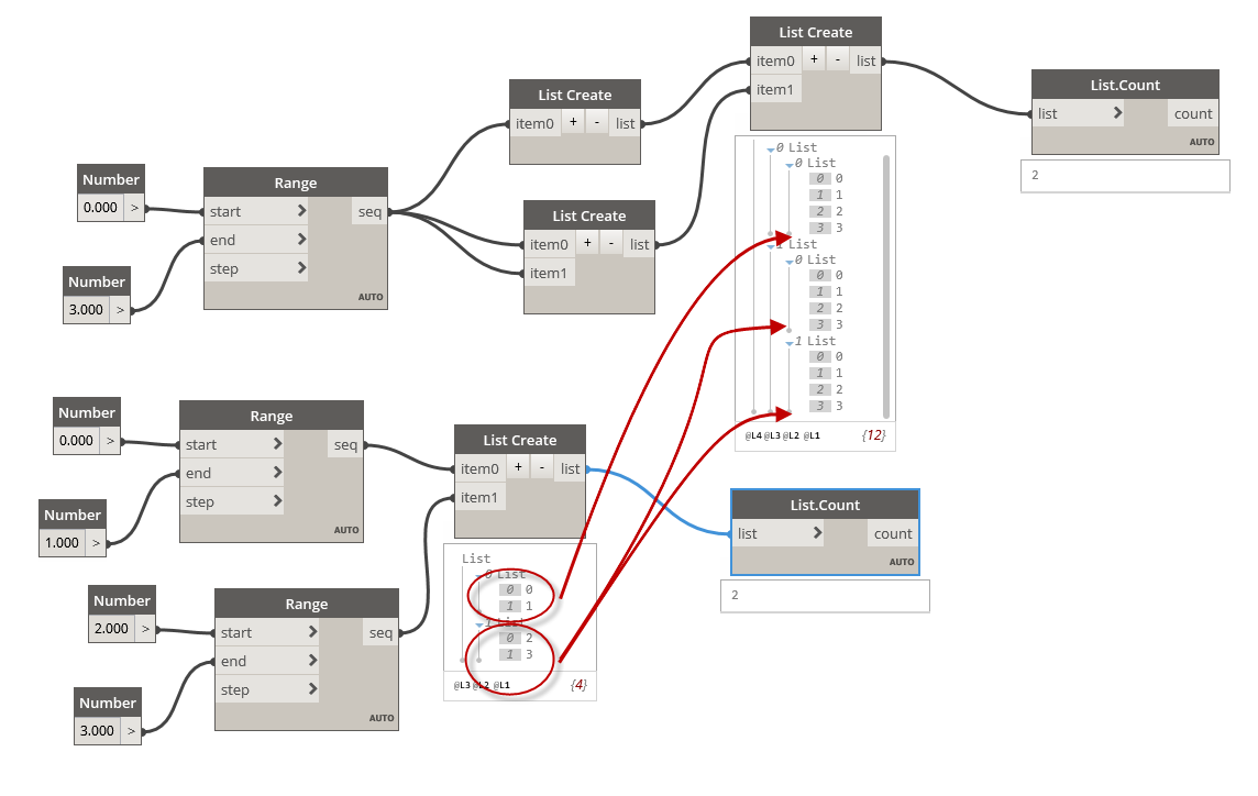

Tried to create a small example, is it something like this what you’re looking for?

Here’s the example with simple lists.
My two lists has the same number of elements.
i want to add each element in each sublist and respect indices.
With Create, Transpose and Flatten, you can combine your 3 lists into a new one.
