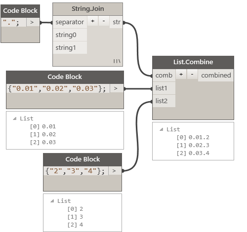

I want to combine these two lists of strings. The first item of the first list is added at the end of the first item of the second.
How can I add a “.” separator in this case?
Thanks!
Thanks @Vikram_Subbaiah, it is really interesting how you use the String.Join with Long Lacing for the separator only before plug it into the List.Combine.

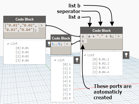

@Einar_Raknes thanks for your approach. I´m really keen on learning more about creating those kind of statements using Code Block.
It is not so difficult. You just put a + (plus sign) between each part you want to join. Strings are quoted with “”.
list a + separator + list b.
Another example:
Great!
