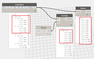

Hello Chander Gupta,
In my graph I was getting Single Solid in Revit after Import, and that is the reason I used List.Map. Let me try your graph and will come back to you.
List.Map is a Node which you can use when you have List of List elements (or List of elements) and you want to Perform certain Operation on each element, then you can use List.Map operation.
see simple example below which explain where to use List.Map and where to use direct function.
Thanks,
Ritesh
