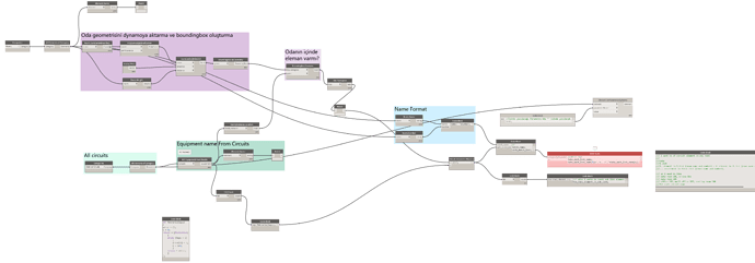

Hello everyone
İ try to giving new name to the circuit on my project.
i create bool list but i can’t match with my name format
Could you help me?

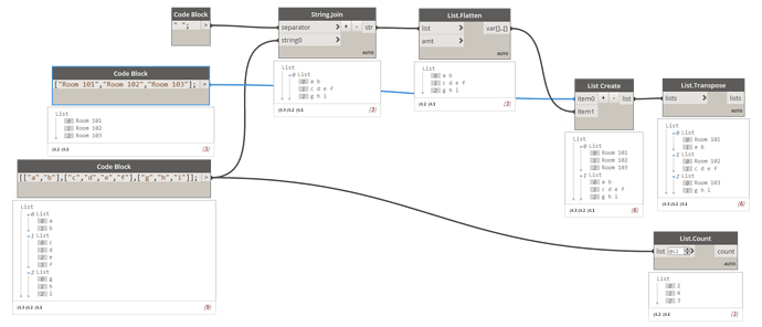

Hi, can you take a quick screenshot of your script? I’m not near my computer right now…
the codeblock with something[0] + "," + ... + something[n]; isn’t a code. It looks like you want to use a String.Concat node though.
Thank u also i can’t do bool list and room list match. Could u help too?
i try to List.AllIndicesOf for true but didnt work.
