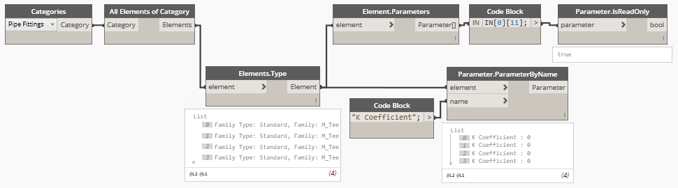

Could you send a screenshot of what you tried in Dynamo?
Perfect. Archi-lab_Bumblebee has fantastic nodes for reading excel documents. If you’ve given that a try, post your workflow so we can take a look.
Well, I just tried the “element.GetParameter…”, but “Coefficient K” is not a parameter… soo yeah, I’m dumb

@willian2142 Here you go…
@willian2142 Please try something and send us a screenshot clearly showing your issues if any.

But this doesn’t get the correct value, it’s always zero. That’s why my question is about the pressure loss report, because revit makes the correct path, like lateral or direct flow, and I can discover it by excel formulas.
