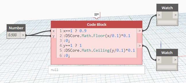

I want roundup and down value by code block.
Value x should be rounddown and if value is 1 then score should be 0.9
Value y should be roundup and if value is 1 then score should be 1
How to fix it?
Regards
How to fix it?
Regards
Hello
Delete your content online 3 and 6
and put a ; at the end of line 2 and 5.
cordially
christian.stan
It works. Thanks
