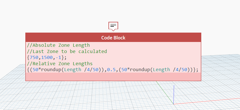

It like like this image! and it is 1 or 2
This is dynamo file can you see if you free time can you fix help me!
this is how the round up function works inside a code block.
Hope it helps!

That is just the round function - round up would take a value of 5.3 and return 6.
It is 1 not 2.
Input a value of 5.1 and it should return 6.
yes, but it depends on the accuracy of the result in question.
Yes it is a question of desired accuracy. However there are many times you wouldn’t want the number below or above to be used. So knowing the uses and methods for using the Math.Round node, the Math.Ceiling node, or the Math.Floor node is very valuable.
Math.Round works as usual rounding you learned in school. 5.4 returns 5. 5.5 returns 6.
Math.Ceiling always goes up to the next integer above. 5.4 returns 6. 5.5 returns 6.
Math.Floor always goes down to the previous integer below. 5.4 returns 5. 5.5 returns 5.
Math.Round is useful when you just want a whole number for basic math stuff. Generally speaking I avoid it as I either want the number above or the number below consistently, and if I’m working with real numbers I might as well use al those decimal points as the CPU can deal with it (usually).
Math.Ceiling is useful when doing stuff like occupancy counts (5.4 people means you have to get 6 people out of that space), or number of plywood panels needed (you can’t buy 5.4 panels after all - you need to buy 6), or any time when you need to work with whole parts to include the fraction.
Math.Floor is useful when doing bin packaging counts (if you have 5.4 units on this floor they can only sell 5), or figuring out how many parking spots can fit in that length of garage (5.4 means you can only fit 5 cars), or any other time when you can’t count the remainder.
