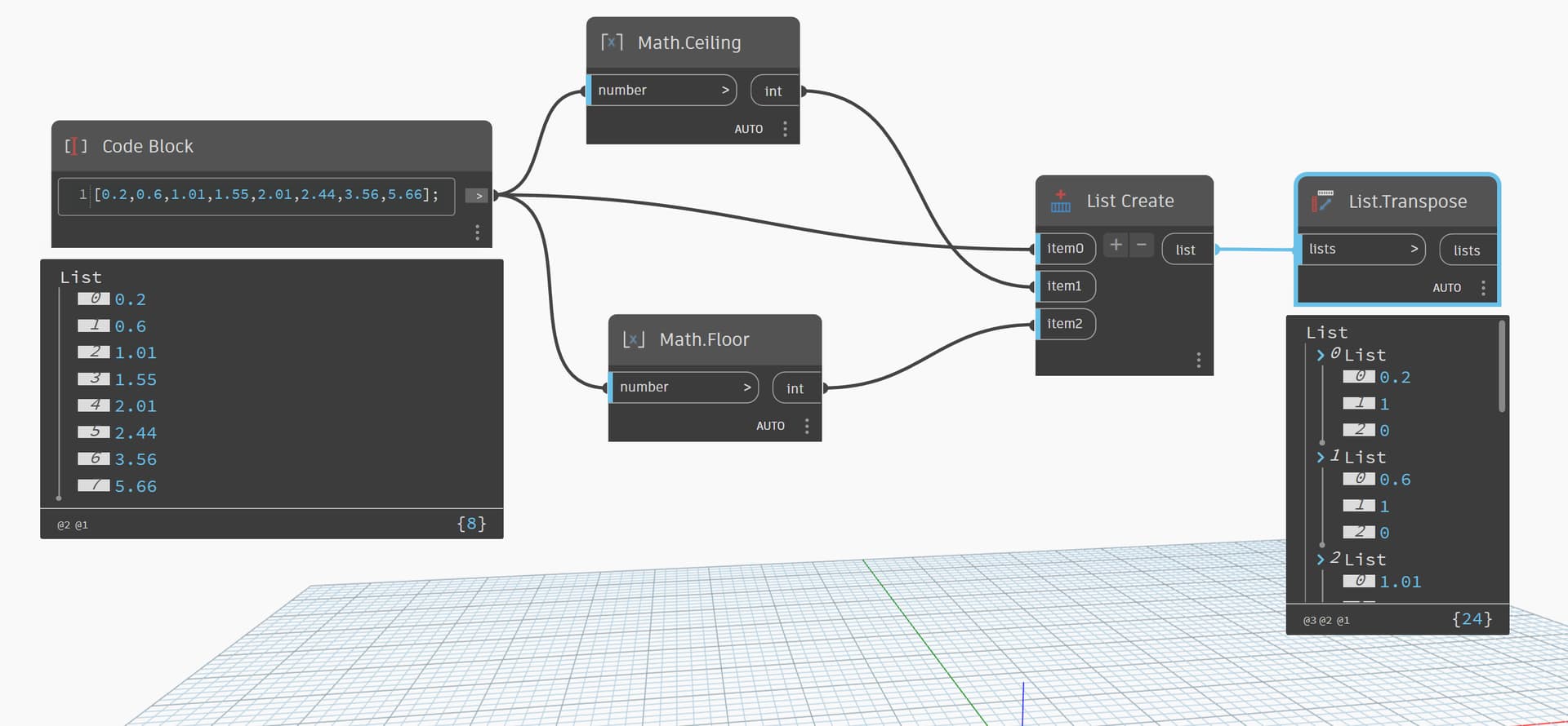

How can I round down or up my values to specific numbers in code block?
Below screenshot with some random values:
Regards

Unfortunately no.
Columns “Down” and “Up” should be in separate lists.
List “value” compare numbers from code block and generate two lists.
List A values rounded down and list B values rounded up.
@Draxl_Andreas
That’s not the point.
For Your values list “Down” and “Up” should be:
Answers for list B and C are from list D.

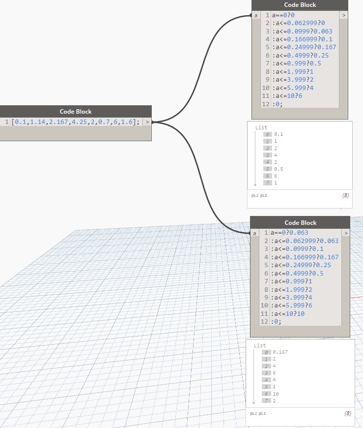

Maybe less professional but worked for me something like this for now.
But I’ll test this solution.

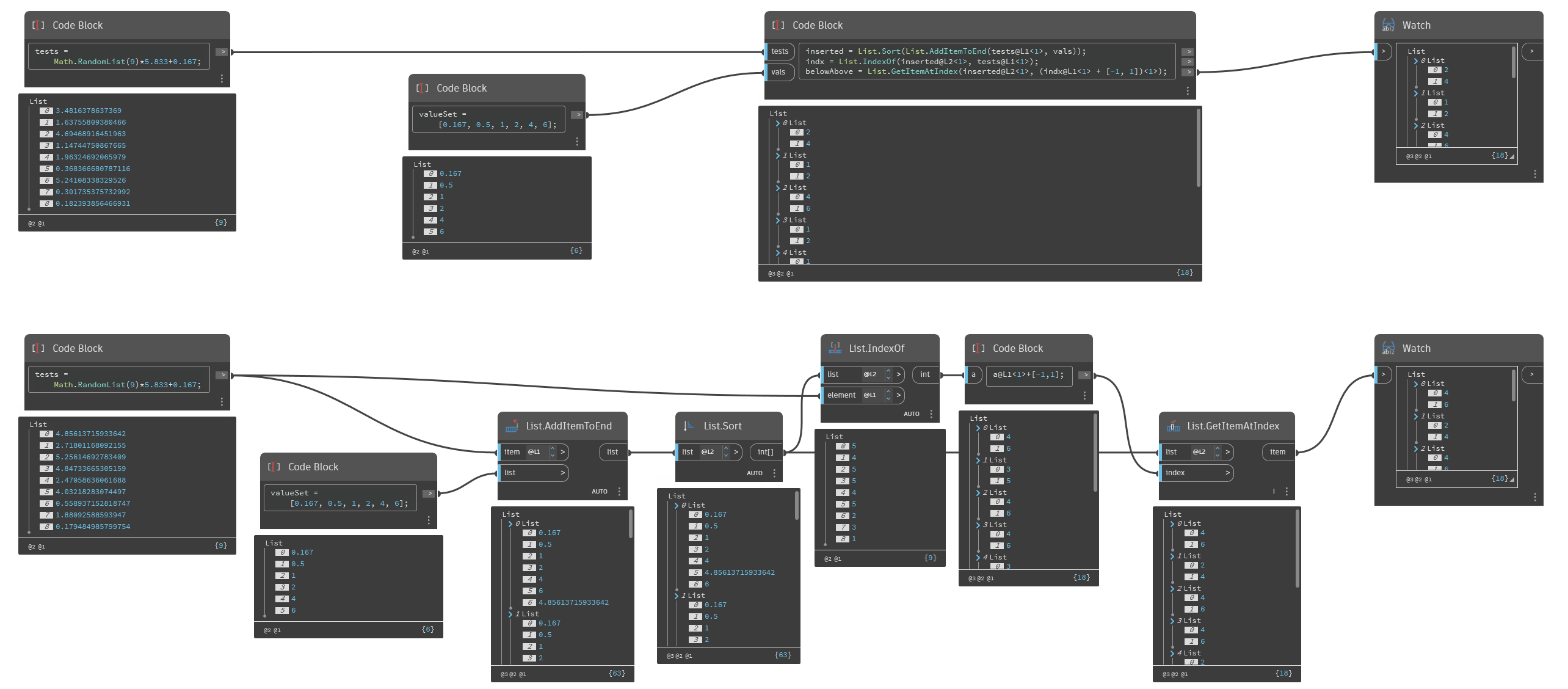

hello, the es2 function is what you are looking for, I left the essai function just in case
def essai(numb:var[],lst:var[])
c=[];
loop=[Imperative]
for (i in (0..(DSCore.List.Count(numb)-1)))
if (numb[i] == lst[0])
c[i]=[lst[0],lst[1]];
else
d=DSCore.List.AddItemToEnd(numb[i],lst);
e=DSCore.List.Sort(d);
f=DSCore.List.IndexOf(e,numb[i]);
c[i]=DSCore.List.GetItemAtIndex(e,[f-1,f+1]);
return c;
return loop;
def es2(numb:var[],lst:var[])
c=[];
loop=[Imperative]
elseif (numb[i] == lst[(DSCore.List.Count(lst)-1)])
c[i]=[lst[(DSCore.List.Count(lst)-2)],
lst[(DSCore.List.Count(lst)-1)]];
else
f=DSCore.List.AllIndicesOf(e,numb[i]);
g=DSCore.List.LastItem(f);
c[i]=DSCore.List.GetItemAtIndex(e,[g-1,g+1]);
return c;
return loop;
cordially
christian.stan

Hello, the if was to manage the case where the value is positioned in index 0 after the list sort (negative index to be discarded)
cordially
christian.stan
