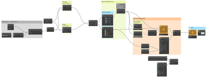

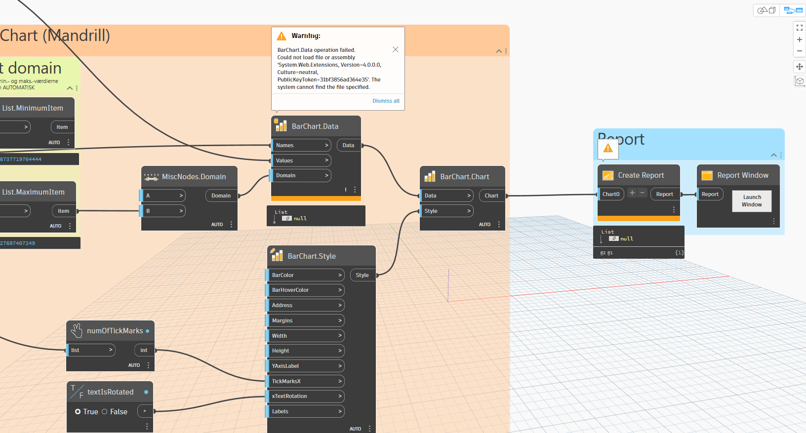

Currently doing DiRoots Basic Dynamo Course lesson 6. When trying to create a bar chart showing Room names and Room sizes I get a waring, which is ruining the report output from Mandrill:
My thought is, that maybe I need to have this exact .dyn-file in the same folder as my running Revit-file, but I doubt that would fix it. Does anybody know how to solve this problem? :sweat_smile:
Best,
Bimster
Here is my entire script:
Hope someone can help!
What version of Revit/Dynamo are you using? This package hasn’t been updated since 2021 for Dynamo 2.6. It could also be an incompatibility with another package or addin. Can you try a simple example with no other packages or addins loaded?

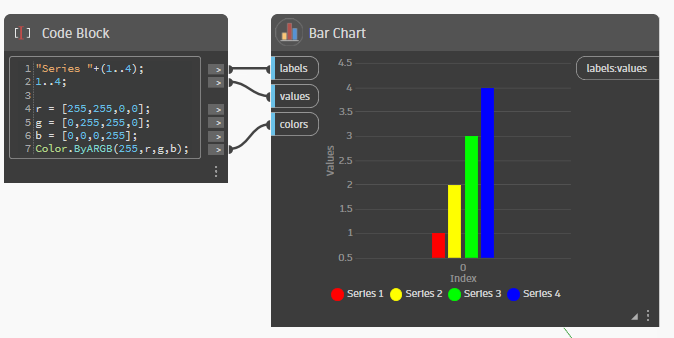

Either way, it’s probably best to use the out of the box nodes that exist now. Try using just the Bar Chart node.
EDIT: I can get a pie chart to work in a recent version of Dynamo but not the bar chart. Have you tried other chart types to see if your issue is specifically with the bar chart or with the package as a whole? Again, there are plenty of issues you could be having here since this is a 4+ year old package now. Best to use the out of the box nodes.
