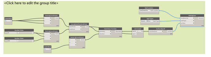

Hello everyone,
I am trying to draw to draw a walls that Have a slope ,I have tried to change the starting point Z coordinates so that it would have a different Profile but my answer is null , I was wondering if there was anyway I can draw a sloped wall with a different profile,
I would really appreciate any Ideas/help, I know that my approach might not be the best solution
Thanks a lot

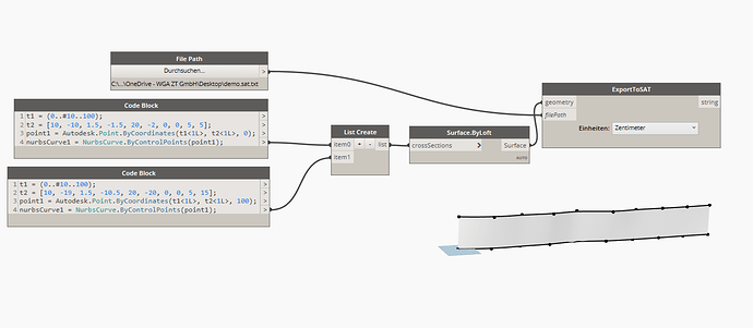

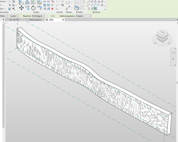

i know just this way. Wall by face means create a generic model import a .sat file and load the family!
host the wall on it…

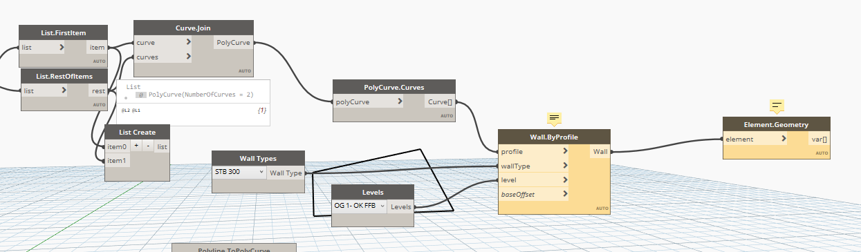

Hi Andreas
I have checked this node previously and I have the same problem I don’t know the reason for it
a issue with Curve vs PolyCurve
Still when I use a simple curve with a Z elevation it doesn’t work,
