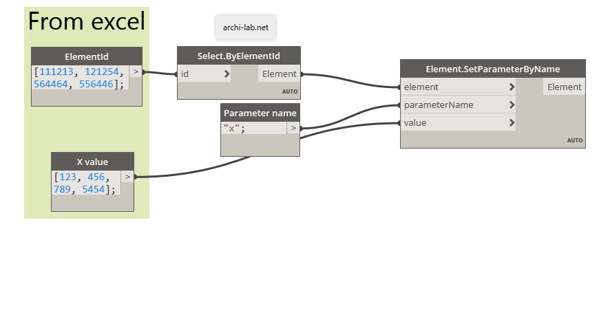

Then it is probably easier to use the archi-lab node called Select.ByElementId and select the elements by the Id’s you have in the excel file and then set the parameter afterwards. It would keep the lists sorted properly.
but how will make the if condition to fill the x parameter ?
thank you in advance
If you do it this way, you do not need an if condition.

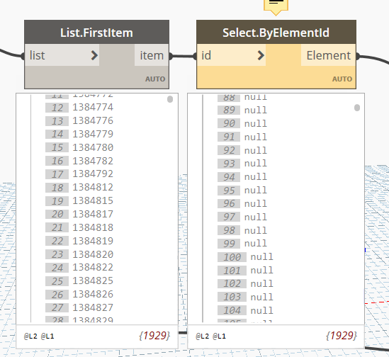

Again, for the third time, please post a picture of your outputs. It helps a lot more if I can see what the output of List.FirstItem looks like instead of guessing wildly what your data may be.
Credit to @Einar_Raknes and Convert Double to Integer
Put a codeblock with x:int[]; between List.FirstItem and Select.ByElementId. See if it works.
And what does the error say?
It looks like you have some nulls in the list, so I would check your earlier nodes and find where the nulls come from. Chances are your problem isn’t from Select.ByElementId but somewhere upstream.
