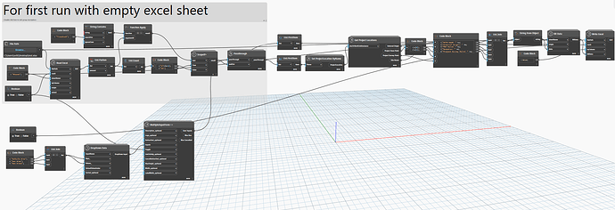

Hi I had a script with similar workflow, it ask the user to choose the Shared site to export after opening a detached copy of the model so the actuall model stays unchanged, hope the swapping site part can help you build your script. Good luck…:slight_smile:
Export-NWC-IFC&DWFX.dyn (132.1 KB)
Navis_DWFX_IFC-Export-W-SharedSite.dyf (88.5 KB)

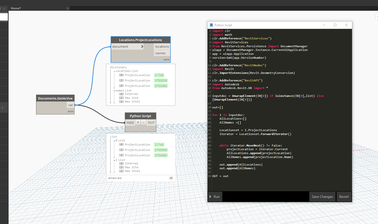

@Khalid.fekry May be you can try the following script I put together to match the output of the Locations.ProjectLocations Node here you go:
here is the code:
import math
import RevitServices
app = uiapp.Application
version=int(app.VersionNumber)
import Revit
clr.AddReference("RevitAPI")
import Autodesk
inputdoc = UnwrapElement(IN[0]) if isinstance(IN[0],list) else [UnwrapElement(IN[0])]
out=[]
for i in inputdoc:
	AllLocations=[]
	AllNames =[]
	Locationset = i.ProjectLocations
	iterator = Locationset.ForwardIterator()
	while iterator.MoveNext() != False:
		projectLocation = iterator.Current
		AllLocations.append(projectLocation)
		AllNames.append(projectLocation.Name)
	out.append(AllLocations)
	out.append(AllNames)
OUT = out

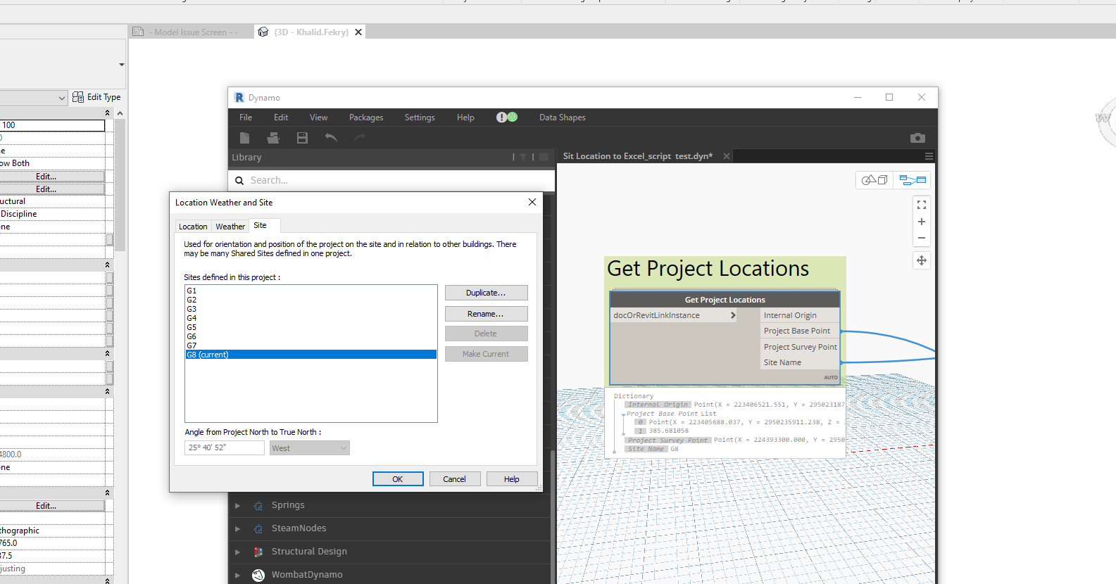

Hi, I tried to get all site locations in the same Revit file by Previous Python code after convert to mm and by the Get project locations node
but notice that the coordinates from the Get project locations node match with the Revit file and from the Python code only the angle match with the Revit file and the E/w,N/S, and Elevation have Slight differences and do not match
can you help with this Issue
Can you perhaps share the screen grab of the entire screen with outputs? also the dyn if possible, I can have a look into it.
