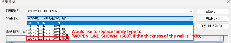

I’m replacing family types of lintels(beams) on walls by wall thickness.
I have created all family types of lintels by wall thickness. (e.g. family type named “lintel_800” should be on the wall type named “W2_800”) I couldn’t find out how I can replace lintels by host(wall) thickness. Could anyone help me with this?

Here’s what I have done till now.
Categories is set as door, I’m sorry that some information is not in English

I think you need the Index.Of node here.
Since you said you made the names according to the thickness, you can just get all lintels and their host. Then through the host thickness, get the proper type name of the lintel and through Index.Of and setfamilytype byname through that.
