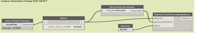

I have created a family, called „Anker_final_LOD100“, with different instance parameters to rotate the object. These parameters are named rot_vorne and rot_links. To place the objects in a Revit Project I created an Excel File with Coordinates and rotation informations in degree. Everytime when I try to change the parameters ALL objects rotate in the same way (Dynamo always takes the last number from my List)
Is it possible to rotate every single object automatically with different values?
Here i tried to change the instance Parameter from one Element and it was working.
Try changing Lacing to longest at set rotation.
