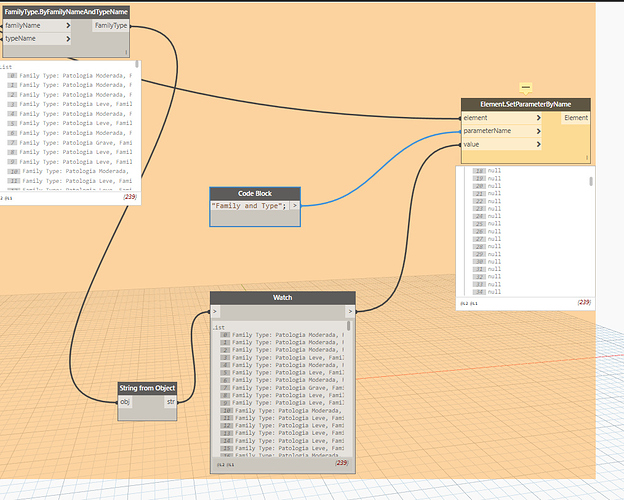

I would like to know if it is possible to change family type and type from elements using a Excel table.
I’m taking from the revit model the following information that I show in the table of excel
The next step that i want to do it is change the Family type from excel and make it change in revit. Is it possible?
The porblem is the last node, maybe im not using correct node
I attach the file. The problem that i have it is in the orange group
De Excel a Revit_rev00.dyn (43.9 KB)
Thank you so much. It is exactly what I need
