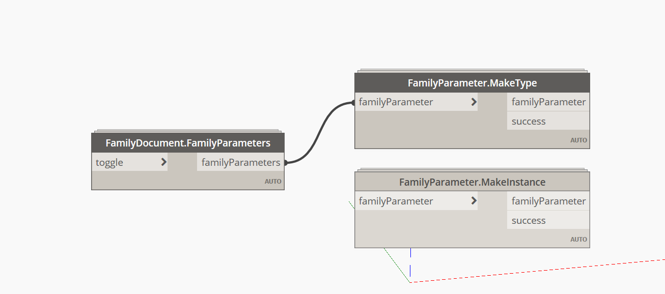

Yes, check out the Clockwork package, that package has the exact node(s) you are looking for

This will replace every single (type/ instance) parameter, in the active Family. To a type or family parameter.
ah do you have to be in the family? is there any way to do it in a project. i have like 300 families with the same type parameter i need to make into an instance parameter
Yes to use these Clockwork nodes you need to run this script from out of the Family Document.

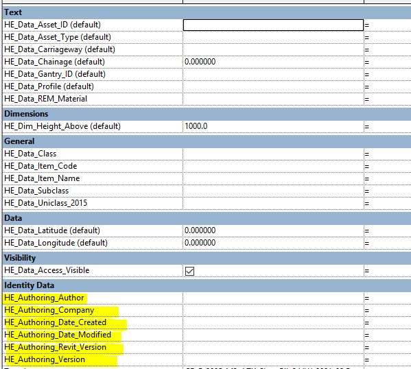

Hi Daan, I’ve been looking in to this and I can’t filter out the parameters that I do not want to turn in to either Type or Instance based. I need the family to have a mixture of both, but want the ability to say “these” parameters are “Type” and the rest are Instance. How do you do it? I’ve tried to filter the parameters out but it’s not working. See screenshot…by the way I’m really new to Dynamo.

Hi Vijay, what I need to do is set the 6 listed parameters in the code block to be either Type based or Instance based parameters.
I can not find this parameter in this family? do you want add this parameter in this family?
The family has the parameters see attached screenshot. At present highlighted in yellow they are set as “Type”. I would like to change these to “Instance”.

you need to put in the actual parameter for this to work (instead of the string/ name)
Try getting the indices in your first list according to your Code Block with List.IndexOf and then List.GetItematIndex
